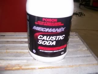

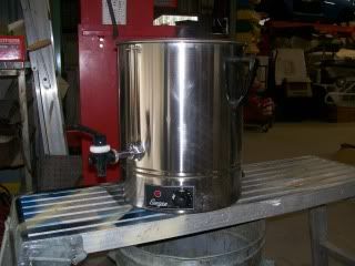

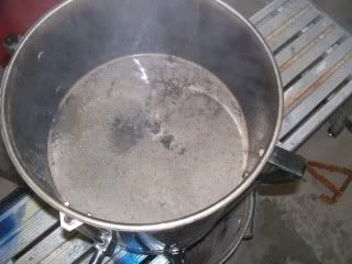

Here's another example that Mick reminded me of... See if you can guess whats going on :wink:
Its my little hot tank!!! great for those small jobs like overflow tanks, subframe parts, small children, anyway.
Yes Mick, the "tea" does taste funny around here,,, but its not cos dad quenched the pistons in the water tank :wink: :lol: BTW I was wondering why the hell you asked about that until I went back and read my post :roll: my old man is over and he was talking to me :oops: sorry mate, not to good at multi tasking :)

Going to work tomorrow and relieving them of the urn in the brew room :lol: Cool idea phats

EDIT--> Mini Maxx, if your going to try and make a caustic tank, just remember,, NO ALLOYS AND NO GALVANISED PARTS,,, I learnt the hard way so you don't have too :wink: I have another hot thank I made out of a site box, its 90 odd litres and I heat it with the eliments out of electric fry pans (3 for them).... only problem is that it takes a long time to heat up, thats why I have the small one as well.
