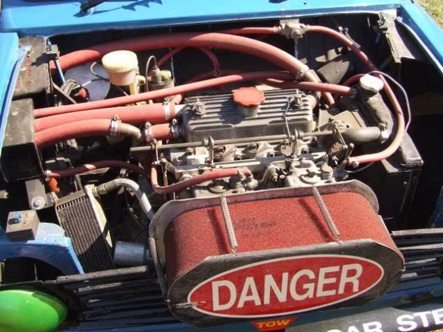

Did someone mention "Engine breathers"?????
lots of big ones here :-)
But it`s only a 1600cc with 13.8:1 compression ratio & 764 cam :-)
PostPosted: Thu Oct 29, 2009 7:54 pm
A great ad for Goodyear Ortac hose right there..
PostPosted: Thu Oct 29, 2009 8:53 pm
Must have very bad bore surface prep hey?
PostPosted: Thu Oct 29, 2009 8:57 pm
Needs more failsafes Matt.

That engine is not breathing, it's hyper-ventilating :o
