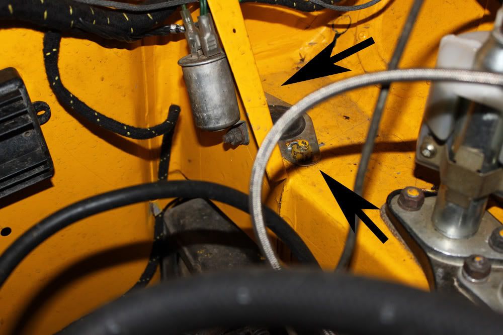

Just here and here

On most dry subframes there are 4 tower studs and nuts. Hydro cars had 4 bolts.
Take those nuts off, it's them. :wink:

Yep, that's them. I couldn't see they served any purpose when I removed one. Probably just tired from the days work on it. I'll remove them first thing tomorrow and let you know how I go.

the tower bolts are the ones you described as little plate bolts,,,yeah those are the ones, same as in the pic above
