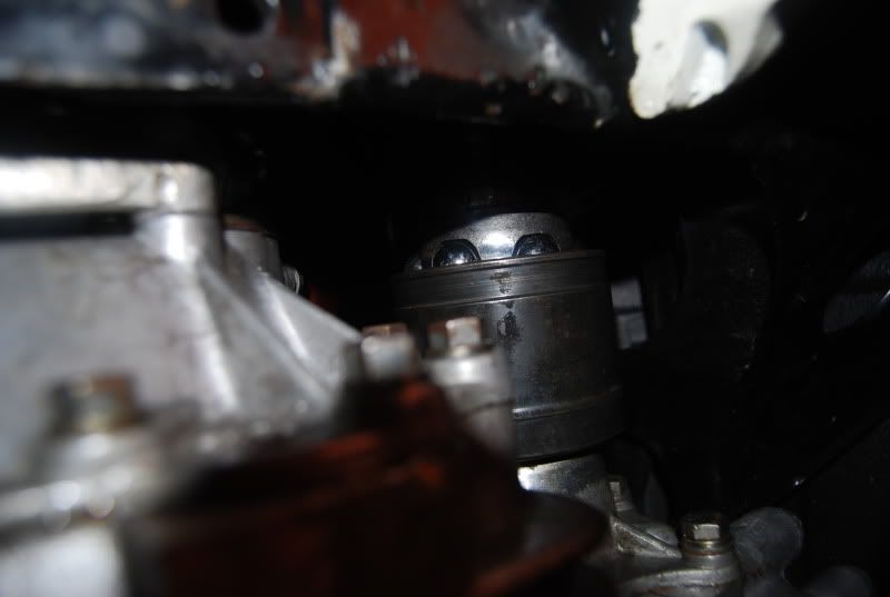

Thanks for the pics MattE. That pot joint (pot roast?) is well out by about 30 to 40 mm. How high or low have you got your suspension set? Yes, the hubs you have are Metro ones.
Has the drive shaft been previously modofied or a custom? You might need to get a hold of another one to check it against.
EDIT> Also might be worther checking the outboard CV to see if it has been ground.

>Thanks for the pics MattE. That pot joint (pot roast?) is well out by about 30 >to 40 mm. How high or low have you got your suspension set? Yes, the >hubs you have are Metro ones.
In rough terms, I agree. I think it's about 25-30mm from where it needs to be...
The suspension is set to give 100mm ground clearance to pass rego. So it's not ultra low.... but in the photo, I've jacked up the lower arm until the subframe lifts off the jack stand, to simulate something in between a resting hieght and having the suspension under compression.
>Has the drive shaft been previously modofied or a custom? You might need >to get a hold of another one to check it against.[/quote]
I checked against two others I have here - all three are visually identical.
'68 Deluxe w/Metro engine
