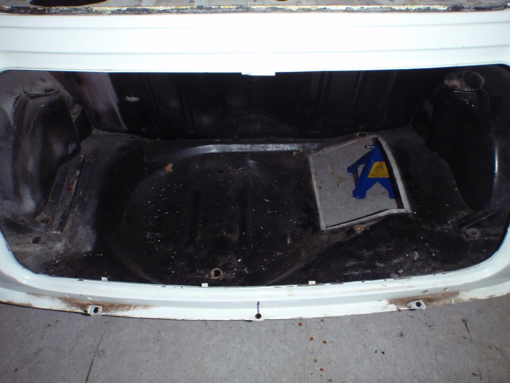

There was lots of running changes in the bodies over the years and there are a few clues to tell what year the shell is by what holes are where. They changed the seat mounts a couple of times and the rear seatbelt mounts as well as a few changes to the floors and bulkheads.
So if you post some pics of the car I am sure that we would be able to tell you what the car is.

PostPosted: Thu Dec 10, 2009 4:27 pm
The pillar where the door lock catch is.
Under the rear parcel shelf inside the boot.
The floor where the seat mounts are.

Photos:
Answers on a postcard to....
The front door hits at the top front corner and notice the gap at the front!
So...roundnose or clubby body?
