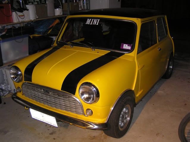

@Austin850 - Nice! What tyres on those? Any trouble with rego?

I was actually running some old steel rims with 145s when I got the car regoed. I put the mags on since then.
The tyres are very borderline. Whilst the sidewall is slightly outside the body, the actual tread is just under the chrome strip. I can always whack on a bit more negative camber to make sure I guess.
The tyres are your run of the mill 10 inch x 165 Falkens. They cop a bit of criticism for their grip in the wet but I reckon that they aren't too bad.

I hope you're right because I'm in the market for some new tyres soon (the ones I have on the above photo have great tread but are 15 years old and hard as concrete). I'd prefer to get A008s but I thought that I read in a fairly recent Miniworld that they were wider. Might have to investigate further.
