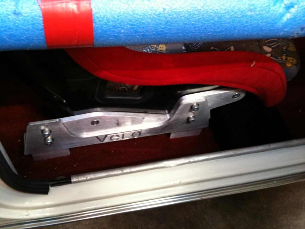

This is how I have my race seat mounted in my Nb historic Car........
Its all made out of Aluminium and its done so i can adjust the rake on the seat.

OK gotya. That appears to be a 'one size fits all' seat sub-frame. Do a search and see if you can get a seat sub-frame from the seat manufacturer to suit a mini. If they don't have them, Scheel Seats in Artarmon can make custom ones. Note that they need to be an approved frame (as does the seat), if it is for road use, so it is not something you can make at home. It may work out cheaper to off-load the seat and buy a new one, so check out costs.

Here you go mini maxx a full pic of the seat......

How has it been mounted in this car? Has the box been cut, or is it sitting behind it?

No cutting allowed in Gp Nb.... :x :x :x It is Billet Velo Mounts with Billet Side Brackets on the seats and some aluminium raiser blocks, with nut plates under the floor. I originally had the velo brackets mounted straight to the floor, but the seat was to upright and too far back and sat too low, when i used the brakes or clutch my legs were at full strech, I'm 5'11 and a bit . so i did some changes, and bought it foward, and up. It sits on top of the tunnel or raised section, whatever you want to call it :lol: :lol:
