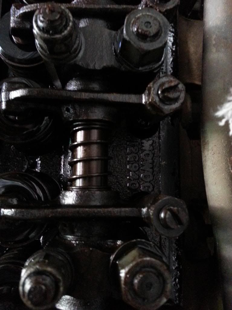

Hi All
Are these rockers standard on an 1100s motor.
Thanks

I've only seen the pressed steel type used on 1100S engines.

Forged Cooper S rockers as in pic were used on early 1100S too. As well as duplex timing chain.
S rockers give less lift than all others. 850/998/1098 pressed ones are better, A+ sintered ones better still, 1100S pressed ones with oval pads were highest lift of the stock rockers..

There you go and I've stripped down a ton of thin flange, small journal engines but I must say that every 1100S I have seen has duplex timing gears.
Re: late A and A+ sintered rockers aren't very good because they are brittle and heavy according to Vizard.
Yes they are, but for a road motor that won't ever see over 7000, I would use them if in good condition.
Their main problem for road use IMO is they are unbushed- when worn inside, you can't fix them.

I have an 1100S with the same head and the same rockers.
The rocker pads seem badly worn tho'.

The pads on S forged rockers do wear, they are not as hard as they could have been. They can be refaced...
The other problem with S rockers is their ratio is inconsistent, giving variation in lift. GR noted this when he wrote up his smallbore engine project some years ago.

Does the above motor have a small journal or the large journal crank?

Can you tell when the engine is still assembled ?
Big journal cranks started at 1100S engine number 12YD/Ta/H10487/10488.
But these days, blocks can have been rebuilt with either a big journal, or a small one.
If you look through the fuel pump hole with a torch, check if the conrods have a big square lump on their caps. If so it's got a big journal crank in.

Ta/H9892

Would have been built with a small journal crank and `Cooper S' rods.
I like these ones better, as the crank and rods are lighter.
You can stroke the big J cranks then use narrowed S rods, but to do it properly (including wedge the crank) it's expensive for the 50cc gained.
