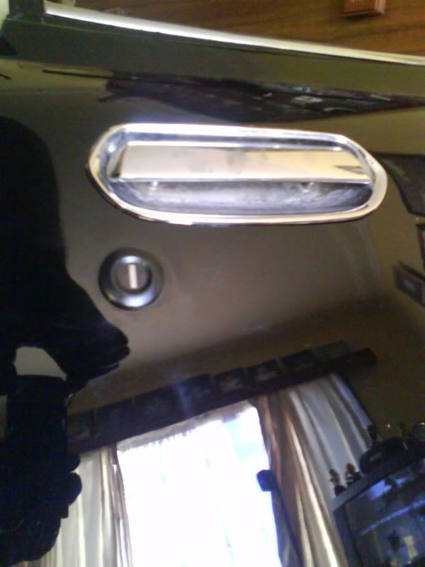

ford Laser locks fit with some filing. This isn't my idea by the way. GZE van was nice enough to pass the info to me.
Product no is ndl22a (a) is for assembled
ndl22ls is unassembled
They come in silver and black and i don't remember what part of the code means silver or black.
My lock smith refused to key it to fit the ign key but GZEVAN said that this can be done... Ohh well. Before I had a key for ign, left door, right door, petrol and van and now I have one less.... no biggie :)
Here is a crappy pic of it installed...
