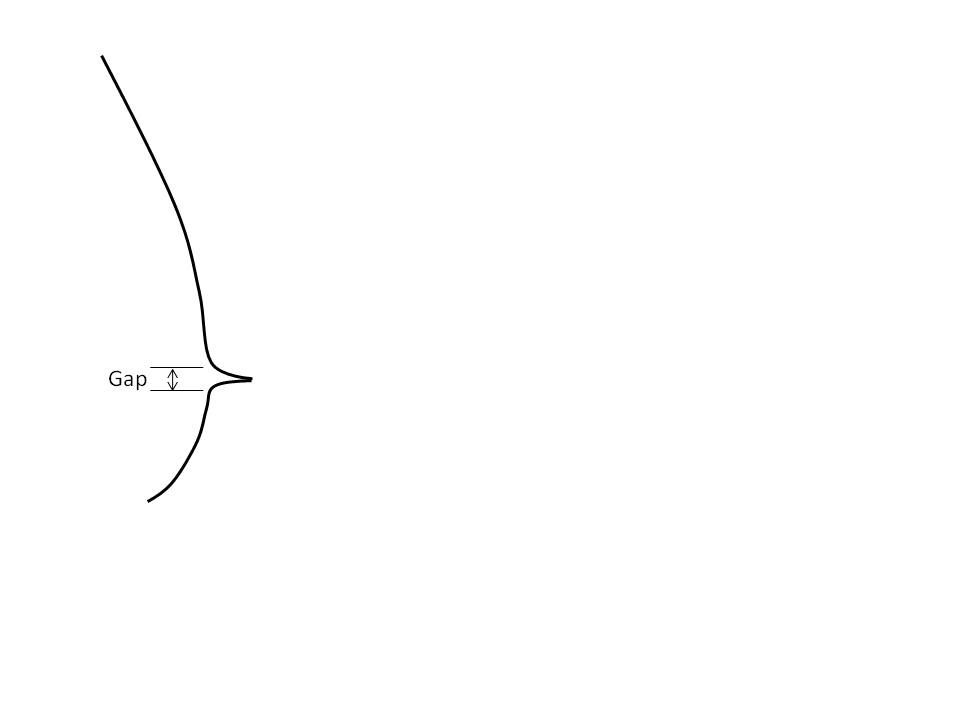

With some spare time on my hands at the weekend I thought I would have a look at how the rear bumber might be deseamed and cut out a 1" section :roll:
The problem is that the panels don't meet at the back at the tangent point of the panels.
As a result, when you grind the panels flush you get a 2-3 mm gap!!! :shock:
What's the secret? Do you have to weld a plate or filler rod at the rear of the panels?

There are 3 panels in there, you forgot the boot floor. :wink:

Yeah - but all that does is split the nipple in half. There are then two gaps.
Mearcat suggests dollying the panels together and then welding.
How does everybody else do them?
I would weld a L-shaped plate joining the floor to the outer panels all the way across the width of where you're deseaming as a matter of course. It won't have any strength there at all if you just try and fill it with weld.

for the vertical seams you weld the gap on the inside first. I imagine that the same would apply for the bumper. Plus adding an angular piece like angusdog sujested is a good idea to go with it.

I remember a number of cars being deseemed in the early 90's and the technique used was to dolly them inwards.
That said, I have seen a number of Cooper 'S's that have been forever devalued as a result of deseeming - there is no going back once you start!

Mike, DO NOT cut all the seam off.
The seam must be cut off slightly proud, leaving enough metal to dolly in and weld together.

yep theres a good how to on theminiforum.co.uk...
they leave a few mm proud, weld it up, then tap it all in, fill and paint.

I must admit that now I've had a structural look at the rear - deseaming must reduce the integrity somewhat.
The rear of the floor (which is holding up the rear subframe) depends on the rear bumper mount to hold it to the body. Obviously it also mounts at the sides and front but that rear section must have a big say in underside rigidity.
Decided to not go deseaming.... 8)
Now...I just have to put this 1" section back in :oops:
