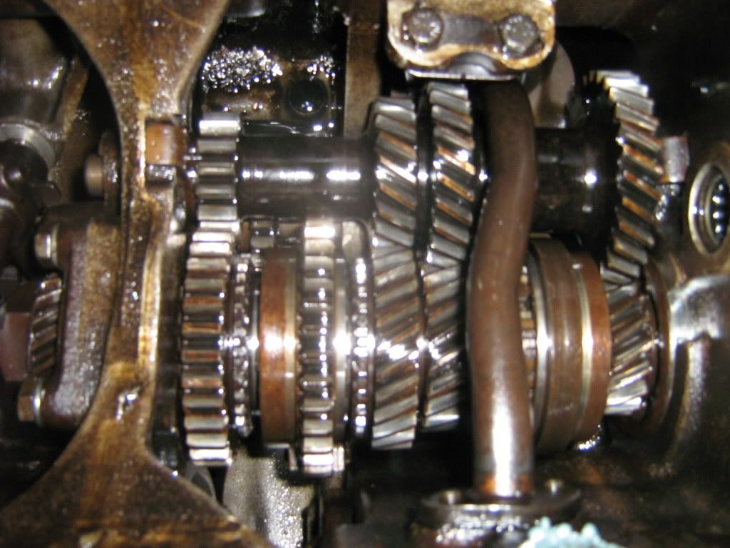

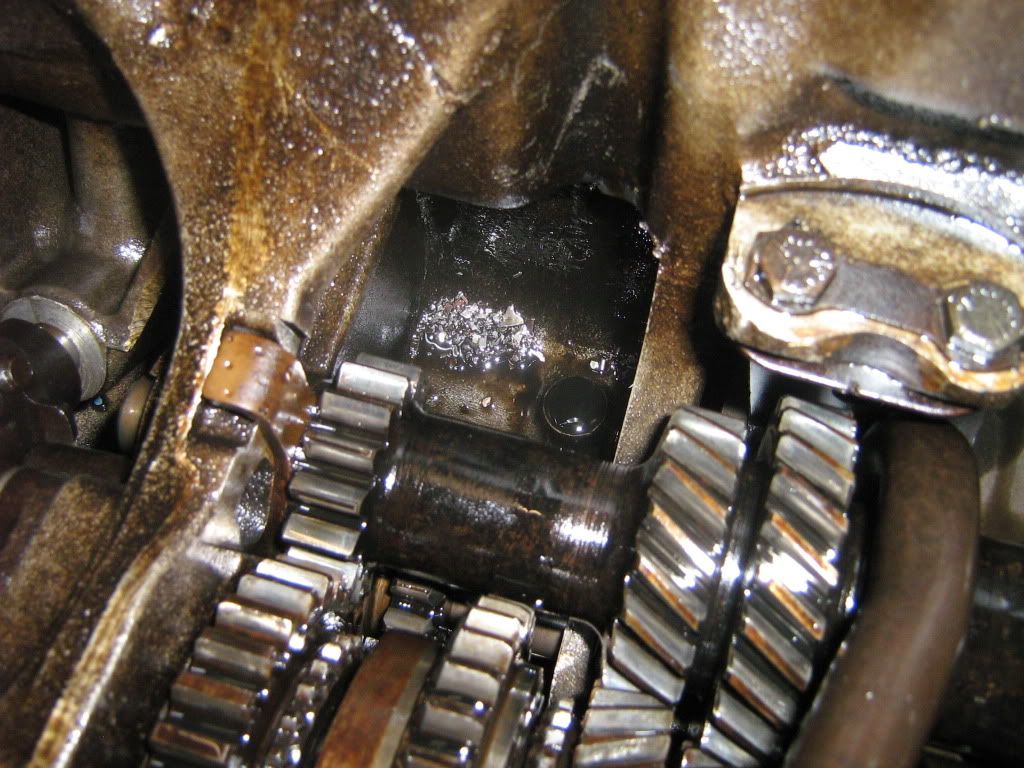

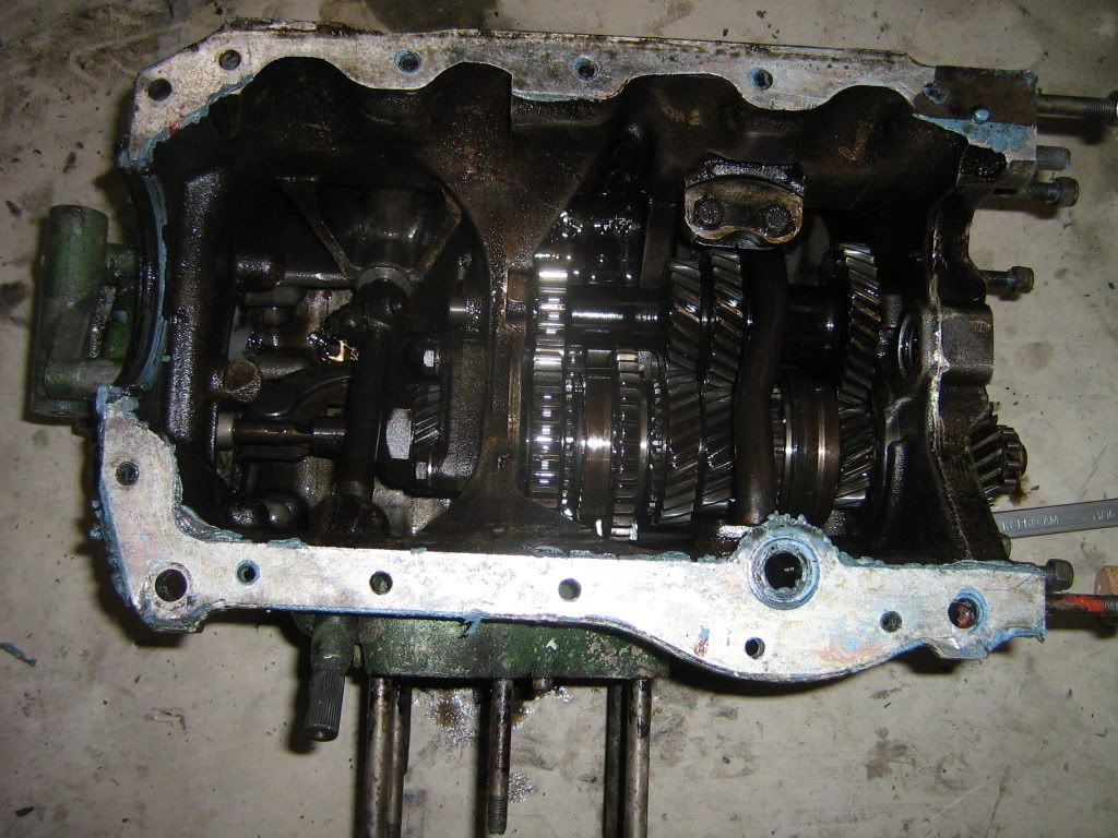

Split the engine and box tonight with mixed results. just had a couple of questions with regards to what i found in the gearbox.
when i removed the diff i found the output shaft flanges were badly worn and the bushes in the output shaft housing were buggered badly and this combined i beleive caused the worn rubber uni joints to flog against the gearbox housing under load.
i was certain this was the only cause of the grinding noises i heard. now im not so sure.
there is quite a bit of metal floating around inside this gearbox and im no expert but the first and second gear syncros looks pretty worn. the box does grind on the odd occasion in first and sometimes in forth if you shift to quick but otherwise the box was performaing well until the grinding noise just the other week, which prompted me to remove it from daily driving.
whats your opinions guys. should i clean it out and just refit it with new gaskets and seals, repair the output shafts & bushes etc, and pray the box will go for a few years.
or should i wait, save up and recon the gearbox.

PostPosted: Fri Mar 26, 2010 1:36 pm
I would pull the whole thing apart. It looks like Mini-K/early Clubby remote.
As a guide to cost, for the Mini-K one I did recently for Morris 1100 the parts bill alone was nearly $500.
This did NOT include new synchro rings- as I clearanced 4 of his good ones and fitted them back in. Nor did it include selector forks as those were both good.
But all bearings were replaced, layshaft, diff pin, diff planet gears, side cover bushes, etc.
Labour was extra. :wink:

PostPosted: Fri Mar 26, 2010 10:19 pm
Posts: 2729
Judging from the lock-washer on the diff pinion, someone has previously had a go at it.
As others have said, while its out, you may as well do a full recon.
That is the only way to get peace of mind and blissful sleeps. :D

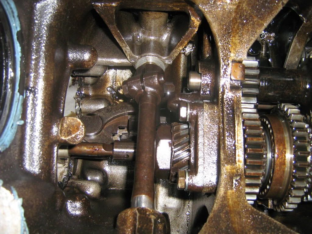

PostPosted: Sat Mar 27, 2010 8:17 am
Posts: 1170
I can see the selector shaft where it coming into the box has been rubbing on the pinion gear retaining nut, not sure why, perhaps it is lose as the lock washer does not look bent over.
as all the boys have mentioend complete strip and build for peace of mind.
they are not that hard but a bit exy if you do the lot.
100% Pure A Series Turbo
PostPosted: Sat Mar 27, 2010 8:22 am
That would explain why there is such a wide unmeshed witness on the pinion...
PostPosted: Sat Mar 27, 2010 9:45 am
Nah,,, i`d say that the double row bearing has collapsed & the whole mainshaft assy is shifting side to side
with all the meatl in the bottom of the box i`d say it`s really stuffed & will need chunks of things replaced deep inside
PostPosted: Sat Mar 27, 2010 10:23 am
Posts: 1170
Very possible
I'd also say who ever fitted the box to the block uses too much sealant :shock:

PostPosted: Sat Mar 27, 2010 11:40 am
Posts: 932
Location: Ipswich
sweet, now thats the sort of thing i wanted to hear. 8) some feedback on what you guys may be able to visually see from these pics and your opinions on what your experience may tell you.
right well when i put your feedback together with the fact there is plenty of wear and a fair amount of metal filings floating around, i am sure this box is very worn out.
looks like i will have to wait. "have patience grasshopper" yes master :shock:
