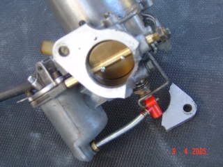

Just when i had it running beautifully :D
it started to run a bit rough then terriblly :( :(
i investigated couldnt see any reason then whilst running sprayefd a bit of "Start ya bastard" around the manifold and she reved up :(
started looking for the air leak ( carbie was re bushed 4 weeks ago)
still nothing obvious so i pulled the thing of thinking that one of the gaskets had gone
boy did i get a nasty suprise
look what i found :o :evil: :evil:
no wonder it was sucking air :evil:
any way after sourcing a 2nd hand throttle body for $35 its up and running again :D
now i have all the mucking around getting the ratios right :(
i guess its all part of owning a Mini :lol:
cheers gadget

Far out!
How the hell did you crack the throttle body like that? :shock:

Buggered if know :?
maybe it couldnt handle the G forces :wink:
worst part is i had just had the thing rebuilt :twisted:
is alloy welding good these days is it worth doing or should i just write it off to bad luck??

dude is your new throttle body as shiny as your old one?
thats one beautiful carby
even the butterfly is polished

Holy crap......................... :shock: . Bad luck right there, hope all is well again now, and you can dial the other one in again 8)

I am intrigued too though. How does something like that crack..? Was it dropped?

No to the best of my knowledge it hasnt been dropped the only thing i can think of is that I may of been a bit over zelous tightening the thing up or it wasnt dead flat not sure.
what i can't understand is why it didnt crack straight away it was fine for 4 weeks then all of a sudden it fails :? :?
any ideas?????

:shock: :shock: that shouldnt happen, was it the carby place that may have done
it, other than that its just weired

Could it be the steady bars on the engine are a bit sad and the engine has rocked back causing the carby to hit the firewall?
PostPosted: Sun Apr 10, 2005 7:42 pm
Not hard to alloy TIG weld it, but it's only a bloody HS4... I'd just pull another off the pile in the corner... :lol:
