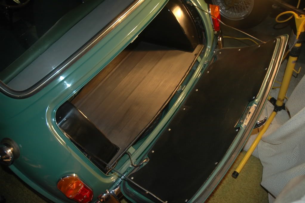

BTW - is it my imagination or the photo angle but does the top of the drivers door unnaturally stick out ????
Mike
yeah, but I think it's just not shut properly

Also note where the door catches on the body just behind the driver's seat. Hopefully just a door alignment problem and not a re-shell and retro fit.
Like Simon says - get a heritage certificate just to be sure.
Mike
There is nothing wrong with the door. it is simply not completely closed. This is a common practice for storing cars which are not used too often. It saves the door sills.

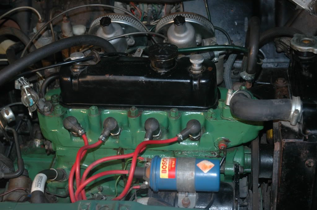

it certainly "Looks" like an English car from the pics,,,, it certainly "Looks" like an "S" from the photos,,, but photos don`t do any car justice & it`s almost imposible to pick if it`s absolutely totally genuine unless you physically eye-ball it in the flesh
the block (however i can`t see quite clearly) lloks like its taller than the water pump & i can`t quite see the large rectangular cast piece under the oil cooler hose,,, maybe get the block casting number from the back of the block if you can
the Right-hand fuel tank certainly isn`t genuine to the car tho, as they came out with only one tank (L/h) ,,, & the few that were fitted with a factory accsessory tank were actually fitted with a welded up type "Serks" tank like mine

But there must be some sort of an alignment issue with the drivers door? Sagged hinges? Its been clipping the body work and has taken the paint off.
PostPosted: Wed Mar 31, 2010 11:51 am
yeah pretty common on the old things hey? just needs an adjust & tighten i`d say
PostPosted: Wed Mar 31, 2010 11:53 am
uh huh... it's just a door FFS

Have another look at the engine shot guys, what is not right about the head?
PostPosted: Wed Mar 31, 2010 12:03 pm
it's a smog head, but 'meh, AEG163 heads are around...
edit: I was more curious about the oil cooler, whether or not it should have one, or if it should be the type that hangs off the oil filter housing... but once again, it's a bolt on part
