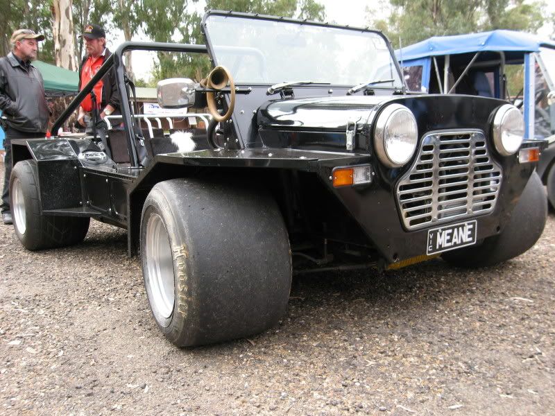

Meane the black moke with the really wide wheels (13" :shock: )
has a steering column out of a Toyota of some sort (Landcruiser maybe)
but it has a couple of uni's in it as well as been fully adjustable.
I may be able to get details and photos.
PostPosted: Mon Apr 05, 2010 9:11 pm
With fat-ass tyres like these I'll bet the column isn't the only steering upgrade! :lol:
