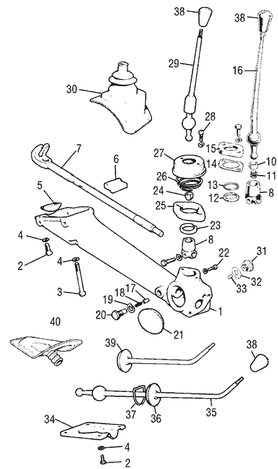

The gear stick in my mini keeps dislodging itself, only just by a bit though.
I can feel when the ball clicks back into position and even then it feels like it going to pop out.
Any ideas.
I have removed the cap and spring and it seems to all be there and it was tight when I took it off. Not sure what to try next.
P.S sorry about my terminology :shock:

What sort of gearbox do you have, rod or remote shift?
Does this happen when your driving or stationary?
If when driving is on accelleration, decelleration or anytime?
PostPosted: Sun Apr 04, 2010 1:26 pm
Joined: Thu Jan 07, 2010 2:17 pm
Posts: 18
The box is a cooper s, to be honest I am new to minis. It has a long alloy plate covering its bits under the car ?!?!
It happens while while shifting either driving or stationary, not while under load of any sort. Well that I know of I just bought the car so I have only really driven it in my street.
PostPosted: Sun Apr 04, 2010 2:31 pm
Posts: 39757
There is a split nylon ring goes under that big spring on top.
If the middle of it wears out (or it's missing) the gearlever ball will come up through the spring.
p/no 22A392, nylon flange retainer.
[edit] nope sorry that's the old Cooper one, it's a 22G292 for Deluxe, Cooper S, Mini K.

PostPosted: Sun Apr 04, 2010 8:59 pm

PostPosted: Sun Apr 04, 2010 9:31 pm
Posts: 39757
CWE is BMC's code for `cease when exhausted', but I think they are still available in UK (Somerfords). [edit] nope, sold out there too.

PostPosted: Mon Apr 05, 2010 12:13 am
The Mini King
Posts: 1338
Location: Windsor, NSW
as per line art Above
12 22A392 Nylon flange retainer 1 CWE - This is the one used on the Cooper ( No Split ) page 118 item 16 Mini King Catalogue
23 22G292 Nylon flange 1 This is the type that was used when the gearlever had the rubber bush in the lower part of gear lever ( has Split ) Page 118 item 17 Mini King Catalogue

PostPosted: Mon Apr 05, 2010 8:50 pm
Posts: 39757
This is Avail here in Australia
Thanks John, I misread the cattledog... :oops:
22G292 is the one we need for Deluxe, Cooper S and Mini K. I've edited my previous posts..
Mini King should have them,
Classic motoring in Melbourne lists them in stock.
If all else fails, MiniMania has them, at a price- http://www.minimania.com/web/Item/22G292/InvDetail.cfm
PostPosted: Wed Apr 07, 2010 4:44 am
