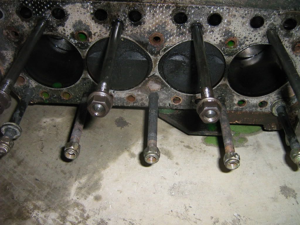

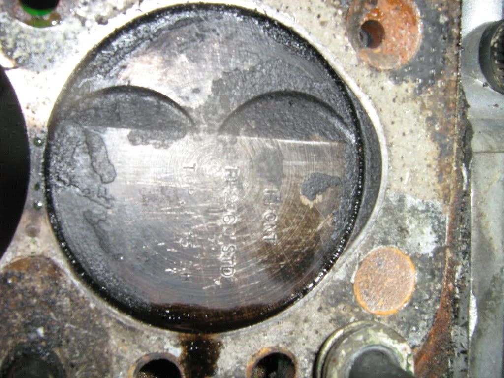

PostPosted: Thu Mar 25, 2010 11:09 pm
Posts: 932
Location: Ipswich
Borrowed a proper mini flywheel puller this afternoon from a guy i work with. Thanks peter.
removed the flywheel and clutch assy and dismantled the clutch housing and split the gearbox and engine apart.
finally had a good look inside, but the results are not what i expected.
i will post a few questions with pics on different subjects as i have plenty of questions, but the main one i would like to ask here is, does anyone recognise these pistons?
i dont think this is a 1210cc engine as the previous owner told me. do these look like normal pistons are are these something someone recognises?
i will take some measurements on the weekend but just at first glance what are your suggestions guys?
thanks 8)
PostPosted: Fri Mar 26, 2010 12:02 am
they look like hillman Imp pistons to me
PostPosted: Fri Mar 26, 2010 1:24 pm
Posts: 39757
Yep, they are Imp, 68.0mm. 1216cc (actually) when used with a 1098 crank.
They are too short to use with a 998 crank.
Good pistons, but very expensive now (the imported ones).
I ran them in my 1st Mini back in 1968, but I used a 12G940 head and a 1275 gasket on it. Copper... :shock: :P

yeh i confirmed this today also. they are hillman imp pistons. i have read they are not to bad.
so the previous owner was half right! :lol:
according to the vizard book these require some offset bore mod's or something from memory, maybe someone has spent some real effort and money on this engine at some stage.
it only has a standard 12G202 unmodd'ed head though. what do you think of that combo guys, 1216 with stock 12G202?
the more i pull this down the more i am comming to the decision i will end up rebuilding this engine, unsure yet, but i think if this head is modded right, with the right chamber volumes etc it should go ok?
PostPosted: Fri Mar 26, 2010 6:12 pm
Posts: 39757
It won't breathe with a stock 202 head.
I would definitely either go find a 12G295, or modify your 202 close to the same, both in the ports and chambers. The stock 202's chambers are about 4 or 5cc too small for those 68mm flat top pistons, which is why your C/R is way too high.
