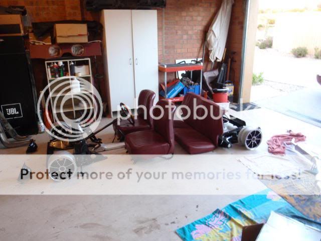

cut off all the bolts that stick out past the nuts and throw em into a tin and see how much you take off.
Drill holes, lots of them. Holes weigh very little.
Cut the front inner guards out.
Cut the boot floor out and replace with aluminum or carbon....
something like this maybe?
