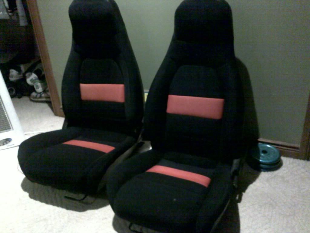

Finally got the seats in! They are a lot less 'huggy' than the sparcos but are much more comfortable and look great!

How difficult were they to put in?
Looks like you just bolted them through the pre-existing hole and away you go?

they were hard actually...
Had to heat the rails and bend the bolt hole flat front and back.
I ran a steel bar between the two rear bolt hole which also propped the back up to a level height.
had to drill new holes for the front.

Nice work Mike, that's another thing ticked off the list.
Did you have them re-trimmed to suit?

I'll get a picture of them folded forward tomorrow..
They were custom upholstered for the MX5 they came out of which was rapped around a pole and they just happened to be black and red :)
