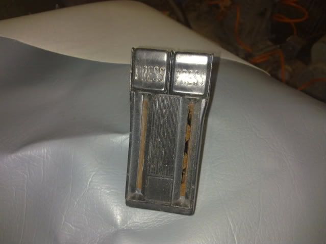

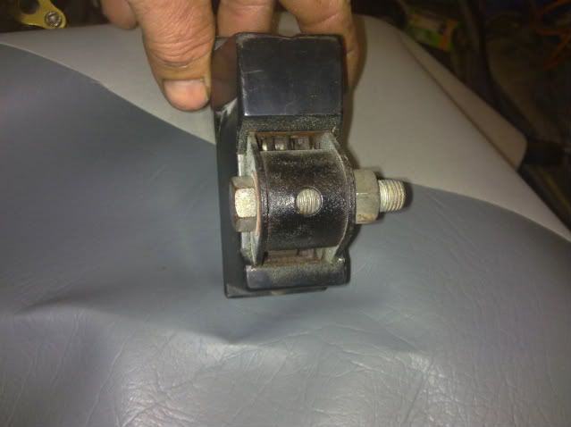

I believe this is what you bolt to that bracket you have....
And here's the back view..
The other holes are for standard clubman seatbelts, I don't currently have a photo of those though. If you want I can get you one tomorrow.
If you want the one in the photos let me know.
