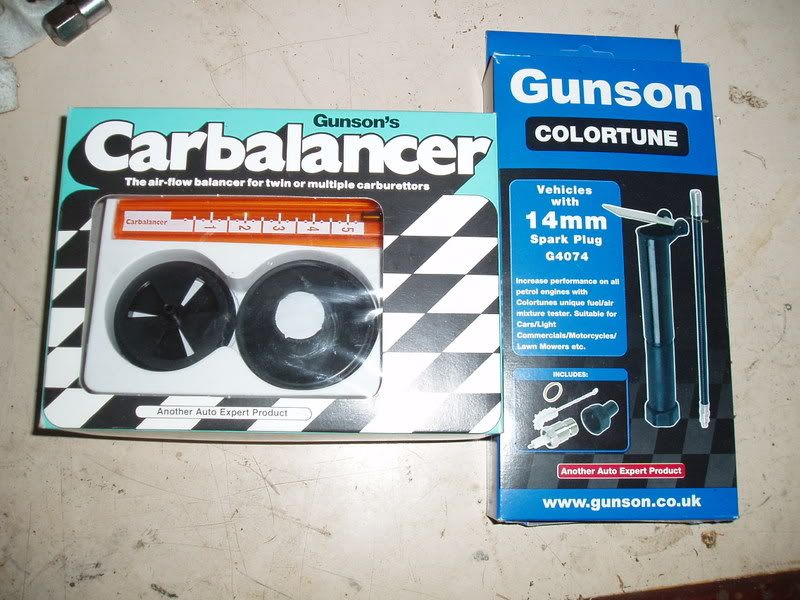

PostPosted: Tue Jul 13, 2010 1:04 pm
Posts: 6844
Location: Cairns, Nrth QLD
Gunsons all the way!!!
