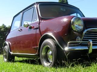

PostPosted: Sat Jul 24, 2010 9:55 am
Posts: 2276
GT mowog wrote:
Little bit hard to see for sure, but it appears the wheels have too much off-set out.
That's the thing, by my measurements my wheels have an offset of 10mm.
Looking at some of the common 6x10s here http://www.minispares-online.co.uk/index.php?cat_id=1&sub_cat_id=17 they are all more offset than mine.
My Widened steels are +10
Minitors (which I like) are +6,
Revolutions are +5,
Ultalites are -3 :shock:
GT mowog wrote:
Raise your suspension a wee bit or do some panel beating.
My suspension is pretty high already (see pic), guess I'll need to have a closer look at the panel.
Have others with 6x10s had to alter the front edge of the guard near the level of the bumper?
