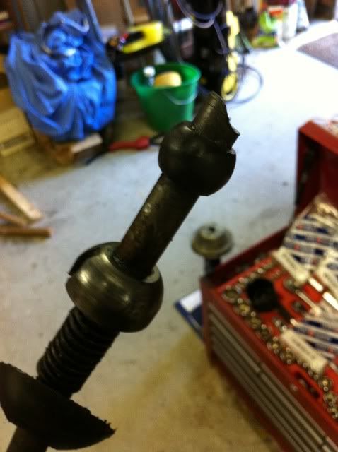

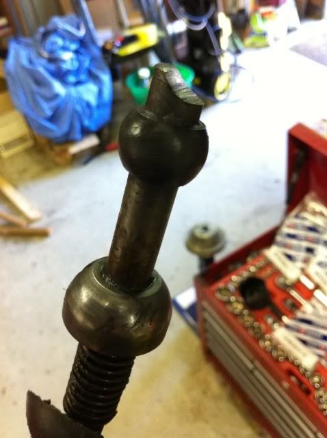

I am wanting to make my gear shifter feel a lot nicer than it does, so have stripped down the shifter itself - only removed the shift lever and bottom plate.
This is what I have found:

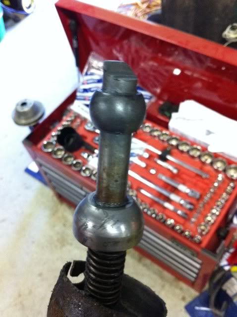

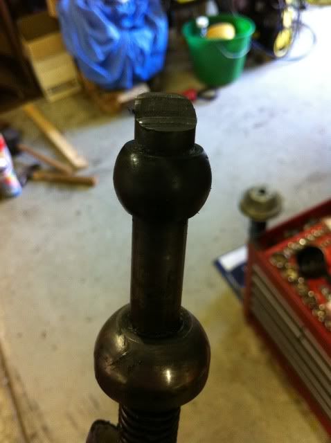

I am quite sure that the end of it has very advanced wear on the rod.

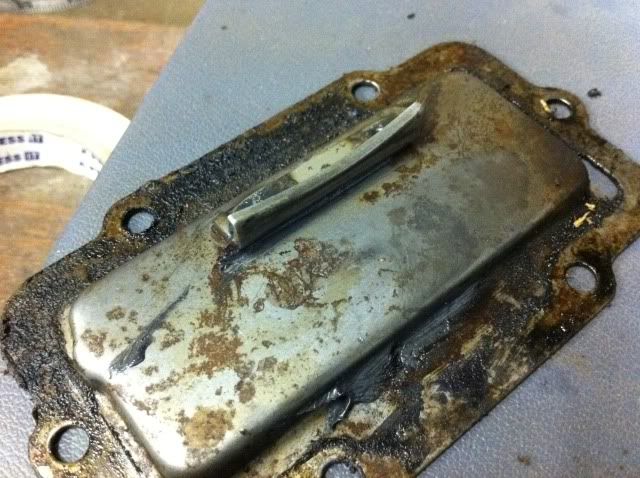

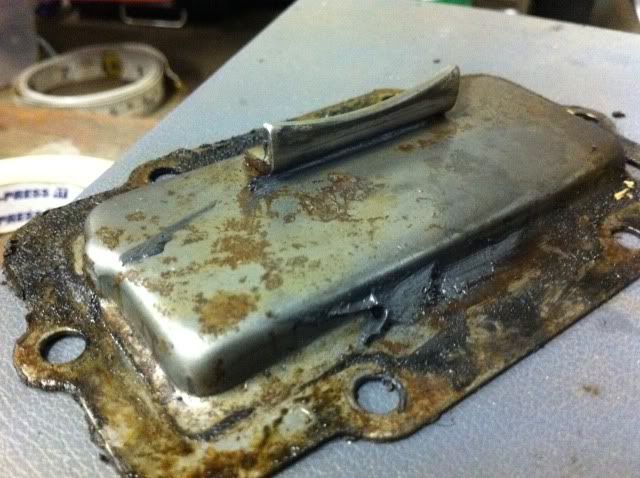

Does the bottom plate look ok?
What else wears? The alloy union that the rod ball pivots in? Do these generally require replacing?
Any tips/help greatly appreciated.

I was just looking at mine today. And yes, I believe that does look pretty worn at the base of the rod. Mine has a small grove from running on the edge at the base, but nothing like that.
The base plate looks OK, but maybe a bit too curved - I'll have a good look at mine tomorrow to compare. The roll balls look fine to me.

I think that curved plate at the bottom is just the reverse detent that forces you to lift the shifter before it will move across into reverse. I don't think it makes the actual 1-4 gear changes any different. I have seen several late mokes with the bottom plate installed upside down so anyone can drive them. That is anyone who doesn't know to lift for reverse.
So the wear on the end of the shaft isn't making your shifts sloppier.

Marky the late mokes had a differnt bottom plate that was specifically made/modified by the factory to be fitted up-side-down because that had fitted the other side of the bottom plate with a spring mech to act against the bottom of the lever instead of that curved plate
i know it sounds funny but if you get the chance to take a late moke plate off you should see the new design spring thing attached to the "now" upper side :-)
& to willy,,, yes the stick is worn on the bottom & Mark is right with it only effecting the reverse lock-out mech
but the slop can easilly be reduced dramatically by simply fitting a quick-shift :-) yeah sorry i`m cheating but it really is that easy :-)

What about the aluminium 'carrier' (for want of better word) that is inside the shifter housing? Does this wear heavily?

Have a close look at the slot on the side of the gearstick. The part which sits in the top of the shifter. If the slot is flogged out, or the pin in the shifter housing part which sits in the slot is worn then the gearstick can flop around a bit. So if you think of it as the pivot point slopping around. Sorry for the really bad explanation.
Otherwise the play is possibly at the other end of the rod change or in the box.

I was having a chat to my local Mini shop a while ago about this exact problem, and the guy there said yes, that "carrier" thing that the ball on the shift lever sits in does wear quite a bit.
