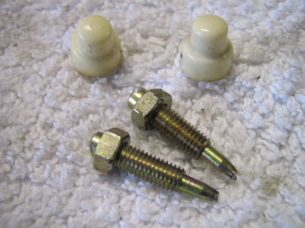

ok dis-assembled the carb and have printed the jetting chart off the weber website, so have started making up the list of parts i will need to set this up to start tuning it.
these are the air bypass screws, they dont look to happy. as far as i can tell these are just screwed into the closed position. does this mean i can clean the tips up and re-use them, or should i buy new ones even though they are closed?
the carb is a 45 DCOE 152
the carb was very dirty and had quite a bit of debris in some of the small orifices. it is also jetted quite large so i am assuming it was off a hipo engine of some sort at some point.

PostPosted: Tue Aug 10, 2010 10:44 pm
Posts: 39757
Most people leave those screws both closed on a racecar or a Mini. :wink:
PostPosted: Tue Aug 10, 2010 10:50 pm
Posts: 932
Location: Ipswich
ok cool, so i can just clean up the tips and screw them back in nicely?
thanks doc. 8)
