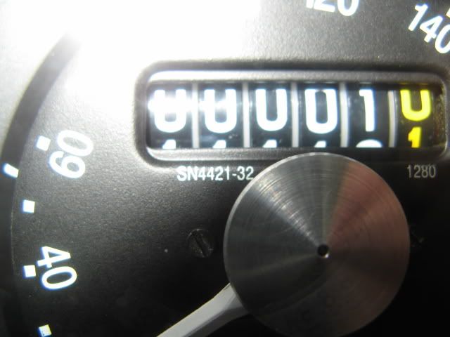

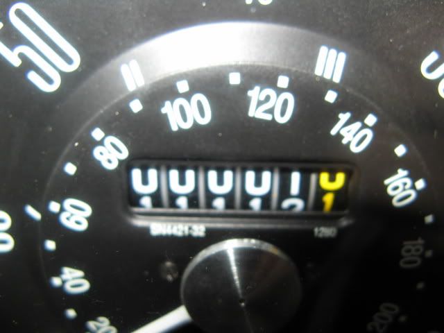

I just got out my old new stock 130mph Cooper S Speedo which i brought some time ago and just noticed the gear change marks between 40-60 mph, 80-100 mph 120-140 mph on my speedo are white arn't they suppose to be yellow.

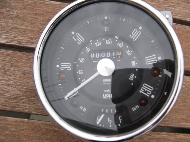

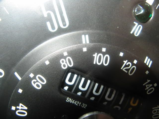

Pictures attached
Ta Kiwiinwgtn
PostPosted: Sat Sep 11, 2010 3:32 pm
Posts: 39755
I think you will find this speedo is not identical to the originals fitted, but they are a (good) repro.
Originals didn't have KMH round the inside (I think) and may well have had yellow gear markings.
PostPosted: Sat Sep 11, 2010 3:37 pm
Genuine repro I suspect..
The english speedos as a point in difference to Oz also had that rolled edge on the chrome bezel you can see in the images...
PostPosted: Sat Sep 11, 2010 5:10 pm
Posts: 1347
Location: Wellington,
must be a repro.
PostPosted: Sat Sep 11, 2010 6:35 pm
I'd say repro too... the speedo I have does have the kmh in the centre, but could be a slightly different font

Speedo 4421/32 is standard fitment on Cooper S 1967-1971 for 1275 with 3.44 diff. Part number 13H4442 and is marked in MPH with black face.
SN 4421/33 as above but with KPH. PN 13H4444.
Information from Somerford Mini website.
