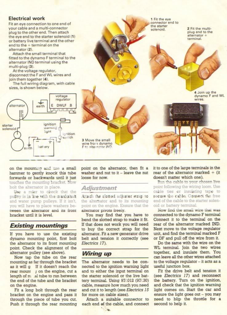

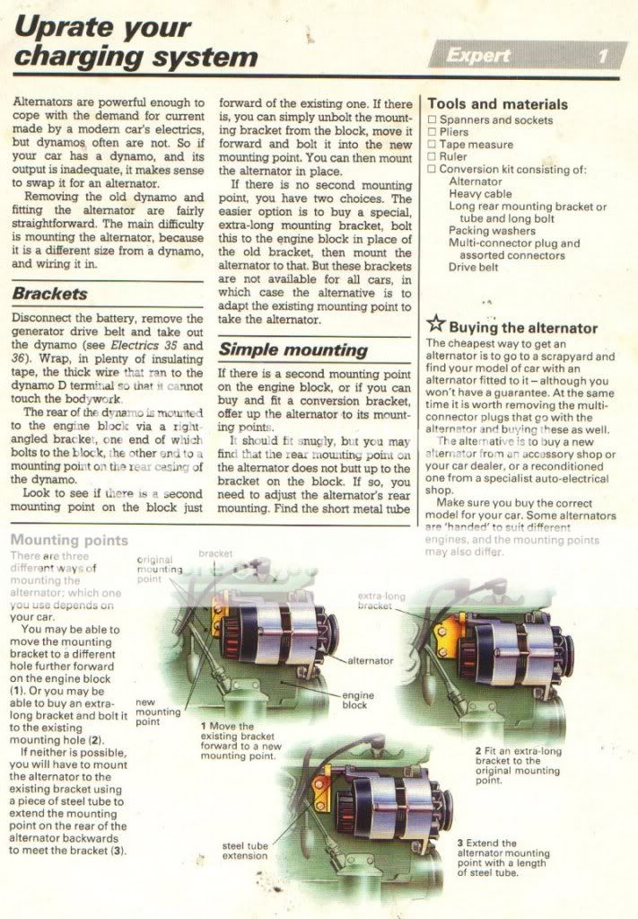

Hi,
If you still have the '63 harness, designed for generator & control box, then this article I came across in a "DIY" subscription thing (that you'd get from the newsagent week-by-week) from the 70s is a great guide for converting to alternator (2-wire).
Funny how in the pictures in the article it looks like a mini block!
Jacob

Thanks jacob havn't got old harness but this will help get a bit more done looks like a mini block to me

thanks vulcan.
it does have a box like that on the left wall of the engine bay, although it seems to have an alternator on it already. Engine seems to be a transplant of a Leyland Mini 998. The wiring is an absolute dogs breakfast.
I may end up replacing much of it. Hence asking for wiring diagrams.
