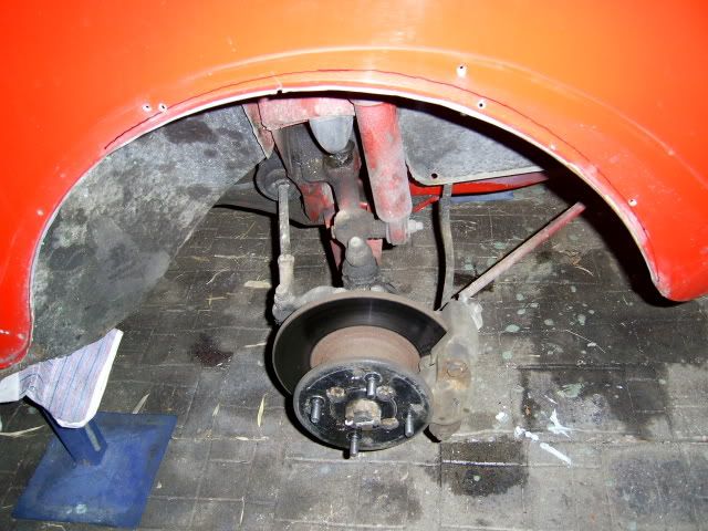

I have a 78' Clubman that im working on. I'm looking into updating the wheels and tyres. Have had 13x7" minilites on it before but it scrubbed all the time and was going to require pretty major mods to the guards to make them fit properly.
For those who have clubmans with big wheels, whats the biggest i can run without having to chop the guards up? I'll probably put some bigger "bolt on" flares on. but dont want to cut up the car.

When I did my rover it was basically just the front of the two front wheel arches. Took me about 2 hours to do nicely. No scrubbing. :D
PostPosted: Thu Sep 16, 2010 5:57 pm
The trimming of the arches is pretty much the same for Clubbie or Curvie
More details on how I did mine here (bottom of page):
http://www.ausmini.com/forums/viewtopic.php?p=634508

Yes Problem! They Rub! Just chop about 20-30mm off front of front guard and tapper it back about 150-200mm round!

It's very simple: Cutting is a result of width and offset.
If you have skinny enough 13, 14 or 15 inch wheels with little negative (outward) offset then guard cutting isn't needed.
On the other hand if you have a set of real fat ass 10 x 10s you will need to cut the arch.
It's not always diameter that decides if the arches need trimming!
