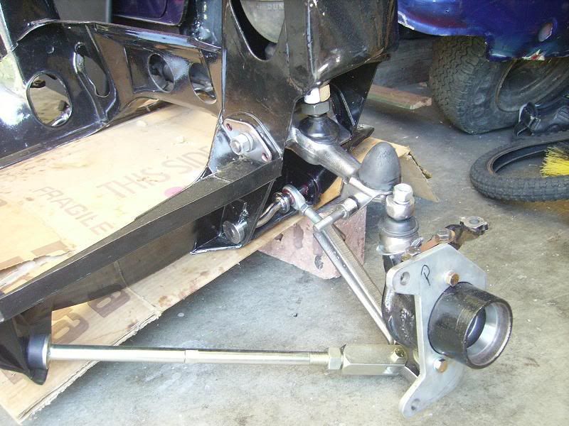

I have a severely bent front sub frame.
could i trouble some to take some pics of a bare sub for me.
top shot, and a side shot of the tower would be great.

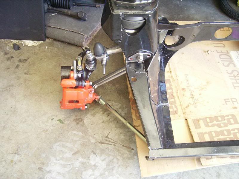

PostPosted: Sun Sep 26, 2010 1:32 pm
is this what your looking for
PostPosted: Sun Sep 26, 2010 3:39 pm
Posts: 1305
Location: Outback Mini Man
haha thats exactly what im looking for, now to give you my address so you can send it to me :P :P :P
but seriously, my towers are flared out, and i can see from yours where my bends are, thanks. Ive had a go at flattening them out, and looking at yours i need to do some more bashing.
