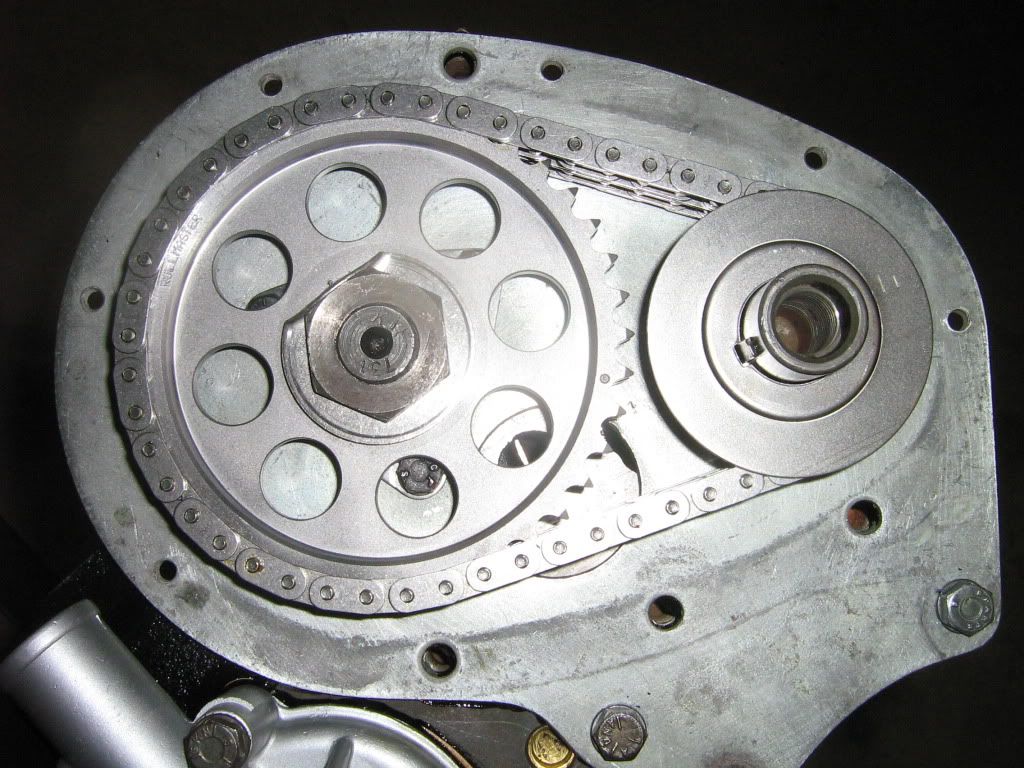

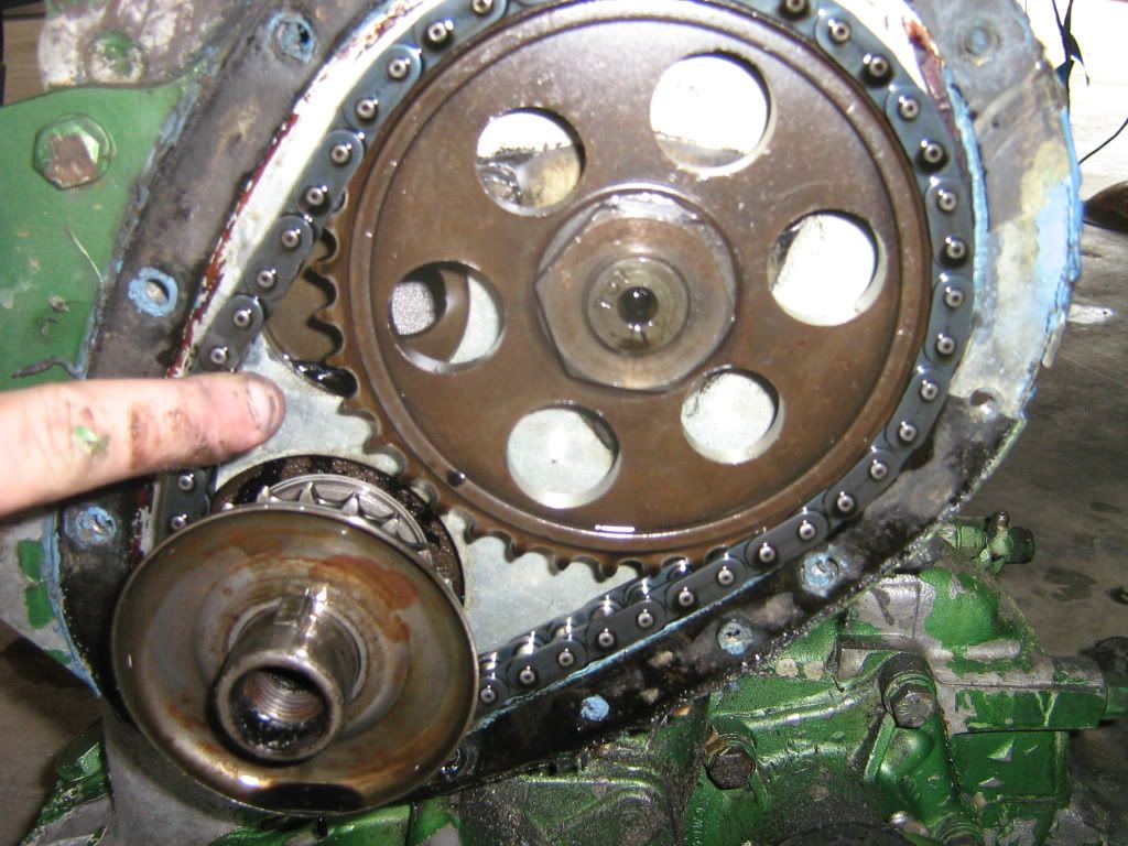

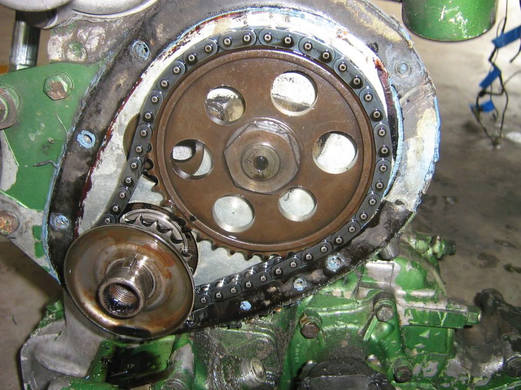

If it looks likes this its buggered :lol:
should look like this. this is a double row rollmaster set.
sounds like you have it under control.
like the DOC said, just ensure the screws are countersunk enough. should be flush with the end plate.
