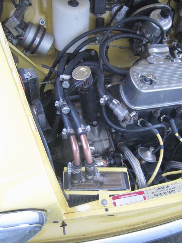

While southwestern B.C. temperatures are moderated by the Pacific Ocean, whereas Tasmania lies in the colder Southern Ocean, all of Tasmania is closer to the equator than the B.C./Washinton/Idaho/Montana border at 49 North Latitude.
Here with hoses connected: head take-off at #4 to heater to intake to rad bottom hose - Fall to late Spring
Here with hoses connected: head take-off at #4 to auxillary rad to intake to rad bottom hose - early Summer to early Fall, when hot weather is encountered and mountains will be crossed under load. Can be partially or completely blocked off to suit (like oil cooler).
Hoses always connected to intake with coolant passing through year round.
