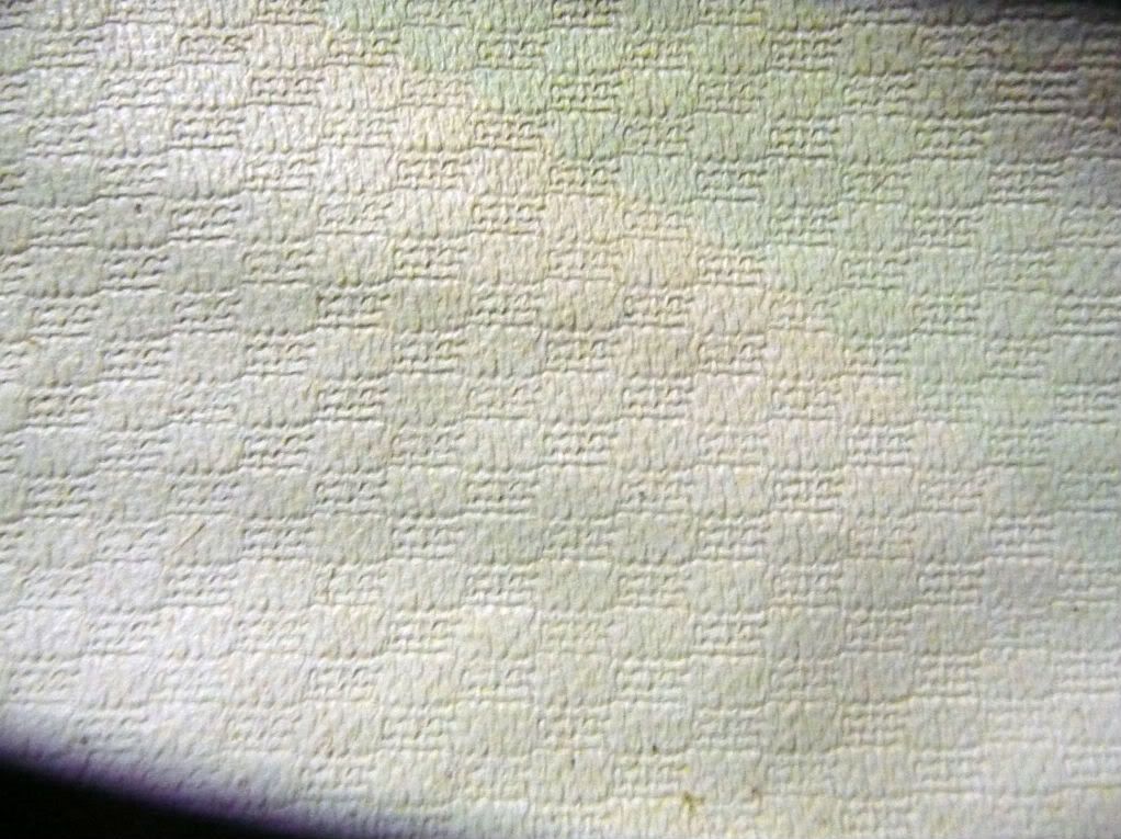

Is this the correct pattern for the Mk2?
yep ;)

Yep thats the same as what was in mine. Is that old material or new?

It’s old material. I need to chase up another one to repair as one panel has some tears and the back C pillars are a total disaster. My S was dismantled 20 years ago and I was unsure if this was the correct hoodlining.
I also wasn’t sure if it was correct as my 72 GT is different, but as Brenton has stated it should be the same. The GT has led a hard life so it wouldn't suprise me if it has been replaced at some stage.
