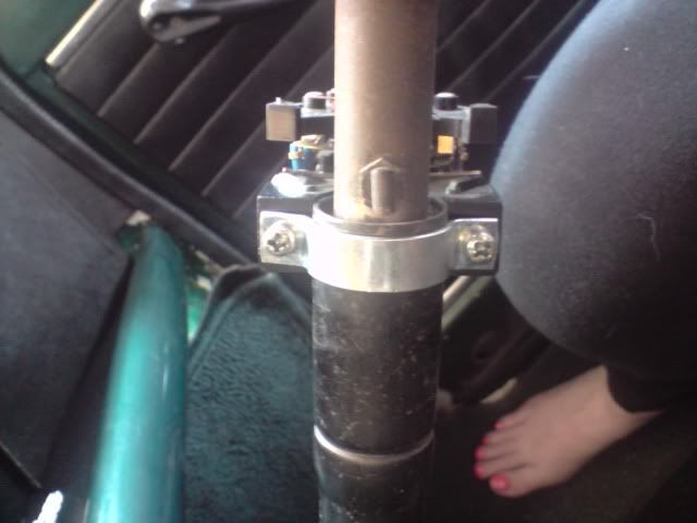

PostPosted: Sun Oct 03, 2010 11:42 am
Joined: Tue Jul 06, 2010 1:21 pm
Posts: 149

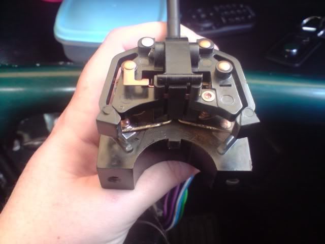

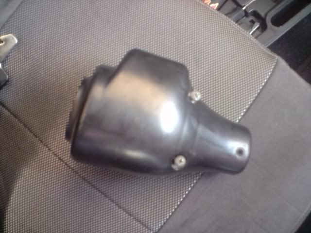

Unscrew indicator housing.
Unscrew side mounts.
What the left stem / right indicator looked like before. This was the issue making it not form contact off position. (front view)

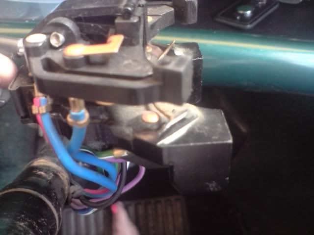

Off position. (Top view)
On position. (Side view)

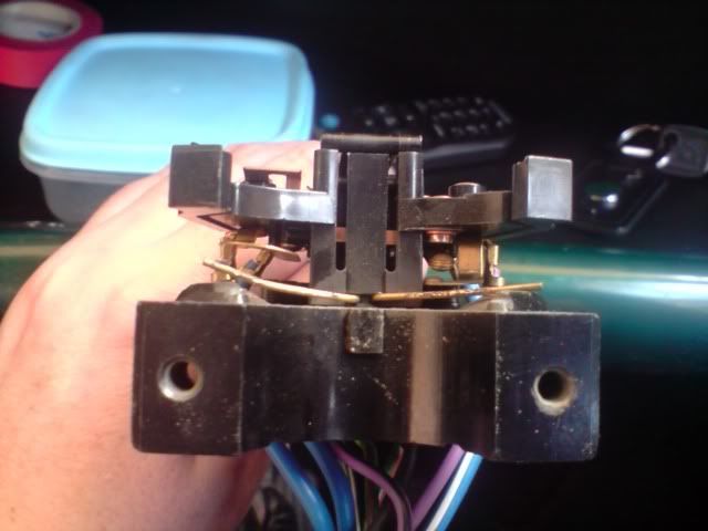

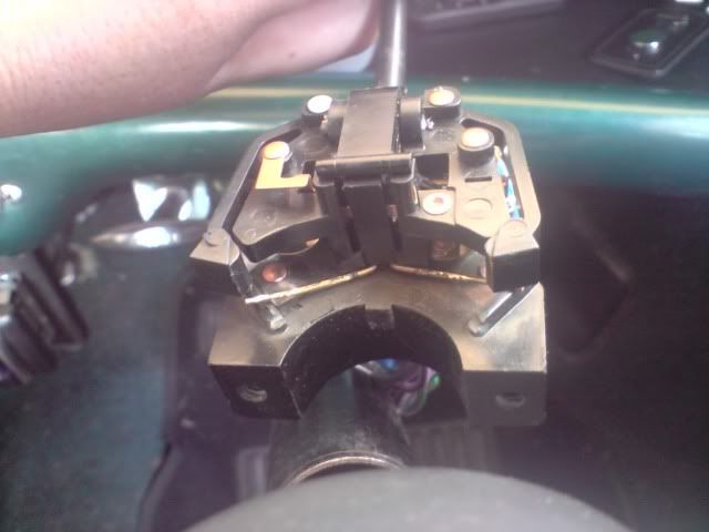

After a little bending and in on position. (Side view)
On position. (front view)

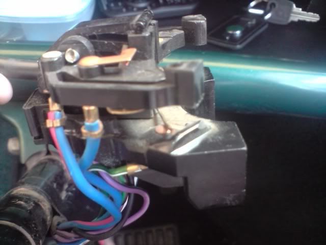

Once completed it should look something like this now. In off position. (Top view)
Then put everything back together.
Manda
Madam Cheglair - 1970 Mini K

PostPosted: Mon Oct 04, 2010 1:25 pm
Posts: 2210
Location: Huon Valley, TAS
Now remember you need to have Pink Nail Polish on before you can tackle this repair :shock: It says so in the Photo's.
Dicko
PostPosted: Mon Oct 04, 2010 4:05 pm
Posts: 3135
Dicko
Pretty toes!
