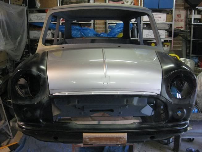

PostPosted: Wed Oct 06, 2010 1:15 pm
Posts: 3166
This is one I prepared earlier.
I have since fitted the angle bar.
