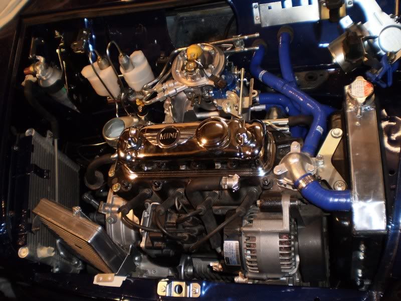

I put AC into my 69 model. Main parts are all seen in this pic:
Condenser on inner guard, compressor under alternator, dryer next to master cylinders.
:D
PostPosted: Wed Oct 06, 2010 10:28 pm
Posts: 1906
mate looking very good!!
I like where that condensor sits harley lol.
you had to cut into the left gaurd for that right?

PostPosted: Thu Oct 07, 2010 7:55 am
There's a ten inch hole in the guard, and the fan for the condenser sits in there.
I actually have to pull the whole lot out soon, if I remember I'll take some pics of how it goes in there. :D
