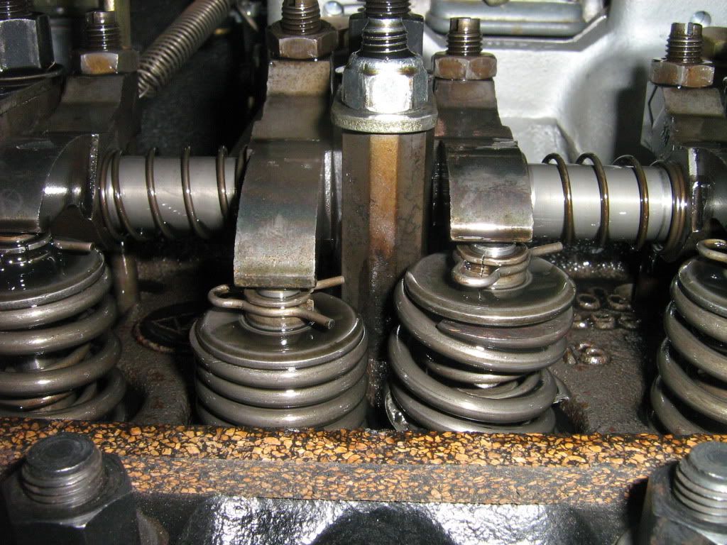

Just went out to the shed after dinner, thought i would tighten the fan belt as it squeeled once or twice during the dyno runs today.
I was thinking to myself, hmmm i might just check the valve stem orings and see if any of them have come dislodged. not sure why i thought that but i removed the tappet cover anyway.
and look what i found.
so looks like the head os comming off now. not happy jan! :cry:

If that is ALL that is the problem, the spring can be changed without removing the head. There is an adaptor that screws in the spark plug hole for connection to your air compressor. Make sure that cylinder is at BDC before turning the air on.

interestingly the car drives like there is no problem with it.
there is no missing or farting or anything. no noises to indicate something is wrong.

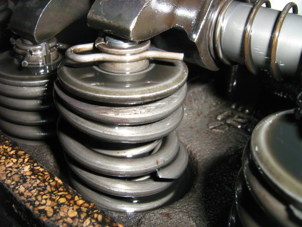

Those springs look coil bound (like Lockie's were), I'd put a set of C-AEA526 on it. They have one less coil so can stand up to .495" lift.

these are CAEA-526 springs. they were a brand new set 1800kms ago when i built the head.
woops- I bought a new set recently too, not fitted them yet. I noticed they were 2mm shorter than the same sort I've been running for 50,000 miles. Those ones were Swiss steel. Made where now? I wonder....
but they are Minipares ones.

correction, they are not CAEA526 springs like i thought they were.
just checked my receipt and they are VSP580P double valve spring set mini 850.
so the CAEA526 is the way to go yeh? man i thought thats what i had.
anyway. better get the right ones.
I fitted these to Lockie's head this time, I hope they are OK.. :wink:
Yeah they are good for up to .495" valve lift and 8000 rpm max.
