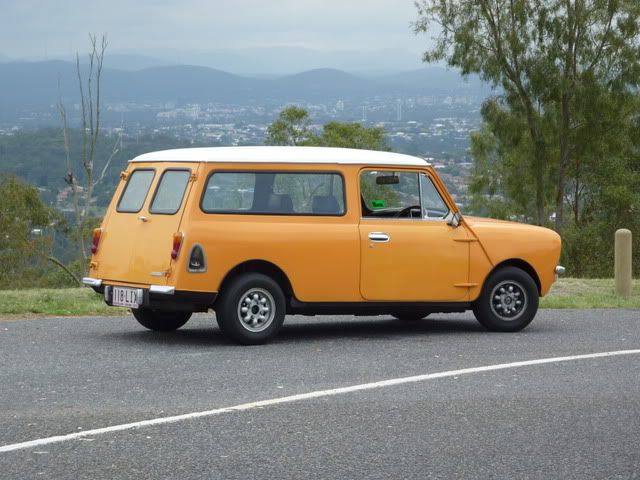

Minilite and a few other companies describe their wheels as 'S' offset, without giving the actual measurement of the offset.
I'm assuming I'm running LS type Contessas, because the centreline of the wheel is pretty much flush with the outside of the wheel rim.
What I'm after is the actual ET measurement this translates to. Thanks for the rough measurements, I'm assuming it's quite a positive offset.
Maybe I should just measure it! My car's 300km away at the moment though...
Thanks for your help!
Average pic here if it illustrates it any better - standard or LS offset?

There were two factory Contessa wheels.
The first was offered as an option on the Clubman GT and fitted to all SS models. These were 5.0" in width. The measured offset (inwards) was the same as Cooper S and Mini S (also 4.5") rims, with an extra 1/2" outwards.
The later ones are dimentionally the same as the Cooper S rim at 4.5" width and same offset. These were fitted to the (998) LS only from the factory. The ET of these is 35 to 36mm.
Yours appear from your pics to be the latter types.

Yes yours are the LS offset contessas with shallow dish
