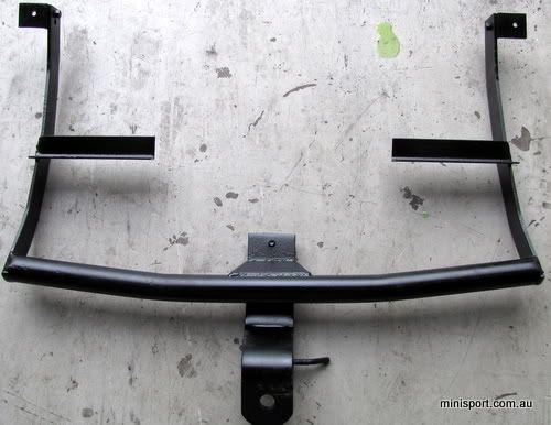

oh and this ones for sale too :)

Andrew,
Is that a new part?
Does it clear the van tank?
How does it bolt on? Subframe?

It is s/hand (we got it blasted and repainted)
It was fitted and made for a sedan (not van)

that thing is beautiful. Is it strange to say that about a tow hitch?
I want one for a van. in BLACK.
