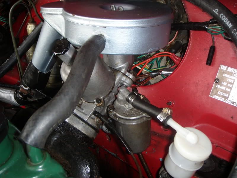

hey guys i have an 850 that has had an 1100 fitted but i'm not sure on what it is out of. i have just bought a new exhaust but am still chasing an inlet manifold but because i don't know what the carbie is i'm not sure what manifold to buy.
it is an su carby but i'm not sure on what size, how can i be sure of what it is?
can i just pull the carby off and measure it or will there be a code that i can reference on it?
thanks in advance.
josh

Does it have a small tag attached to one of the float bowl screws? If so, what's stamped on it?
PostPosted: Sun Dec 12, 2010 2:00 pm
Supercharged
Posts: 1246
or post a pic
PostPosted: Sun Dec 12, 2010 2:16 pm
Look at the bolt pattern where the carby joins the manifold.
If it has two studs one straight above the other it is a 1¼"
If it has two studs on an angle it is a 1½"
If it has four studs in a square it is a 1¾"
This only applies to the normal run of the mill SUs.
The end. :mrgreen:
PostPosted: Sun Dec 12, 2010 2:27 pm
Mods rock!
Posts: 5079
The end. :mrgreen:
The H4 carbies, which is 1½", as sold by BMC (through ST) also has a stud pattern simiar to the 1¼".
The HIF 38 and HIF 44 which are 1½" and 1¾" respectively also have a 4 bolt pattern, similar to the 1¾". These were fitted to the latter UK cars and many have found their way out here.
Throw up a pic would be your best bet.

[/img]http://i165.photobucket.com/albums/u61/norco_ryde/mini/P1010053.jpg[img]
[/img]http://i165.photobucket.com/albums/u61/norco_ryde/mini/P1010054.jpg[img]
[/img]http://i165.photobucket.com/albums/u61/norco_ryde/mini/P1010055.jpg
PostPosted: Sun Dec 12, 2010 3:29 pm
Mods rock!
Posts: 5079
It's an 1¼" known as a HS2.
