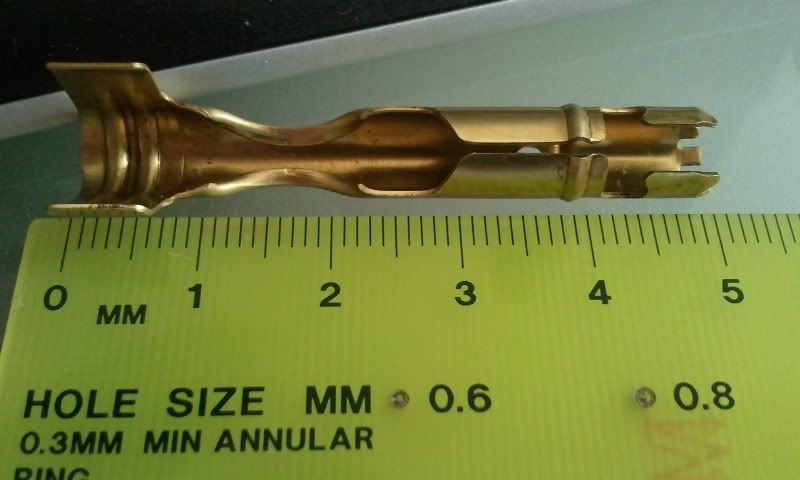

I'm after a cheap spark plug lead crimping tool, so I can make the spark plug leads for my EDIS coil pack.
The connectors look like this:
It's just an overgrown crimp, and all my searching locally has yielded just overgrown prices! :cry: :x
Can anyone point me in the direction of a cheap (<$60.00) crimping tool? :?:
TIA, Jim

Could you not just use a normal crimping tool for non insulated terminals? I have "repaired" a few leads in the past, and have carefully unfolded the terminal with a screwdriver, then with a bit of care, re-folded the crimp with normal pliers.
Andrew
PostPosted: Thu Dec 16, 2010 5:56 pm
Posts: 848
Location: Hoppers Crossing
Andrew
I have several crimping tools, but none are big enough to crimp it. :(

Hi Jim
A few years ago I was faced with the same problem.
I decided to make a simple tool for use in a vice.
Here are some pics to show what I did, worked a treat.
Hope this is of some use to you.
Dave

PostPosted: Thu Dec 16, 2010 7:32 pm
Posts: 722
Jim,
How about this???
http://cgi.ebay.com/ebaymotors/MSD-Crim ... veQ5fTools
Dave

Quick search of eBay....
How about these ?
http://cgi.ebay.com.au/IGNITION-CRIMPING-TOOL-SUITS-FORD-CHEV-HOT-ROD-/350420677186?pt=AU_Car_Parts_Accessories&hash=item5196b33242

Gee how many "Hours" did that cost to make... You can buy a proper tool for around $25.

Thanks everyone. I ordered the ones MINImal effort found on Ebay.
I wanted to get before Sundays Grand Farce Tour, but looks like I'll use my old leads on the EDIS coil pack as an interim measure until they arrive. Cheers.
