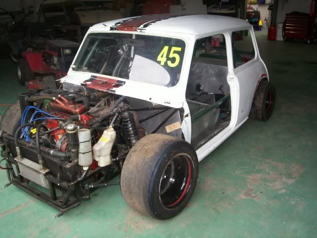

PostPosted: Wed Dec 22, 2010 12:42 pm
They do.
The suspension geometry must be adjusted accordingly.
Or do people like Walden have it all wrong?

PostPosted: Wed Dec 22, 2010 4:31 pm
awdmoke wrote:
They do.
Race track is different to the road, i can use much higher boost on the track with ill effect.
i'd be willing to bet there are 10" wheeled minis out there that handle better..
PostPosted: Thu Dec 23, 2010 10:51 am
Mini Mad wrote:
awdmoke wrote:
They do.
I don't see much standard componentry in that front end either!
the A series in there looks so out of place
