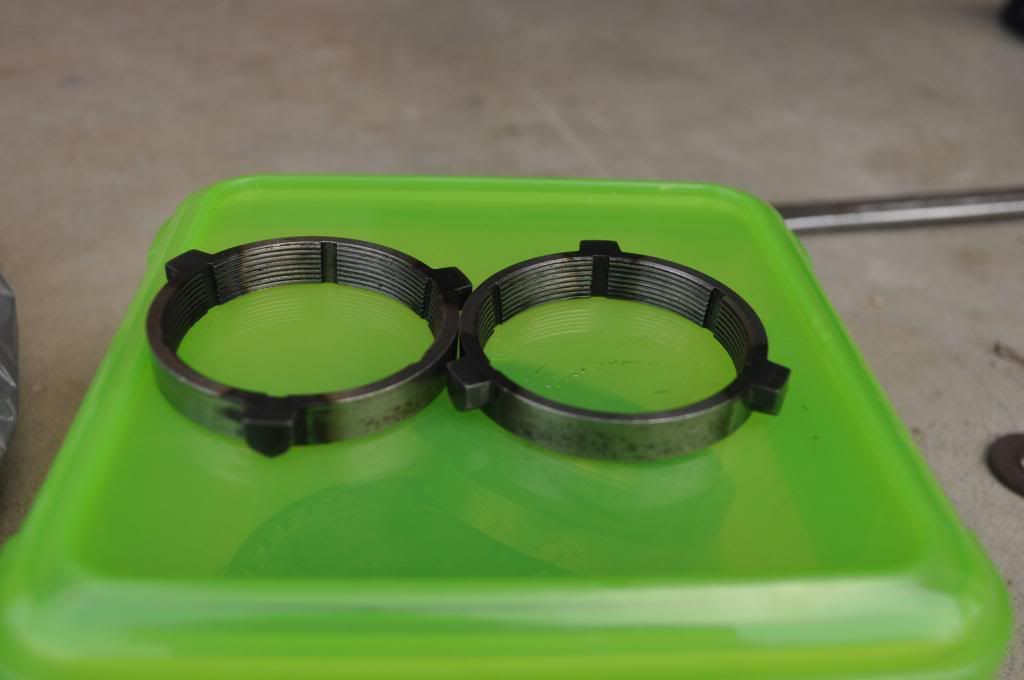

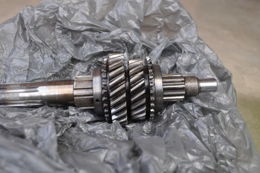

OK, so I have some photos...
The cones look good to me, the grooves on the baulk rings all look the same on each ring (some do have bigger gaps than others, but over 30 thou).

PostPosted: Thu Oct 31, 2013 8:06 pm
Irish Yobbo wrote:
does look pretty smooth - I'm no guru, but I had a look at some of mine and they're a lot more emery-paper looking than that
does a synchro ring bind up when you push it on and try to turn it?

Irish Yobbo wrote:
A syncro ring doesn't bind when you push it on - but how much is it supposed to bind? Should I be able to turn it easily by hand? What's confusing is that all gears change smoothly except second - and I can't tell the binding on 2nd gear apart from the others.
normally, if you put a synchro ring on the cone and give it a twist like you're screwing a lid on a jar, it'll bind and you won't be able to turn it by hand - it binds there and you need to unscrew it to get it off again. If none of your synchro rings will bind up on that gear, then yes, the gear is cactus
that's the way the synchromeshing works when you're driving, the synchro hub is pushed across while it's turning, the synchro ring connects with the cone, binds up and makes the gear go the same speed as the synchro hub, then the gears mesh and off you go in the new gear

if there is no air gap between the gear cone and syncro ring it will not bite, if its a new ring then the gear is worn out.
The gaps are all really good - the lowest was still over 30 thou, and the other 3 over 40. I think they came from the factory with about 45 or so.
camp freddy wrote:
Irish Yobbo,
That second gear looks good to me, nothing obvious there.
It might be worth looking careefully at the Syncro Ring.
It may have a break in it and is spreading when it is pushed onto the cone and then springing back again.
Just a thought, I have seen this type of thing before.

I'll have another look, but I don't think that's the issue either. I tried with all my baulk rings, and none of them seem to grip.
