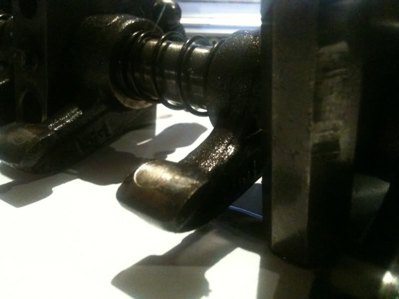

I'm burrowing through the garage sorting out a set of rockers for the new 998 build. I've got a set of 1.5:1 forged which took a bit of damage to the pads earlier this year from a shitty set of valve stems. They're marked lightly on 3 of the pads.
I'm torn between paying to get them done professionally at a machine shop, making a jig of some description or just gently resurfacing them on my linisher. I think I could polish them pretty well, but realise the curve is important as well. Has anyone tried this and failed?

Not on a linisher.... too hard to keep the face square.
I do the Toyota Corolla ones on the bench grinder. On the side of a fine wheel. WITH ROCKERS OFF THE SHAFT!
I make sure the tool rest is dead square to the wheel. As long as you are only taking a few thou off, it works.
But trust me, machining is my trade... it may not work OK for you. :lol:

I have done hundreds like that Mick, with either a linisher or a bench grinder, using the side of the wheel. If you have ever seen or used a W&B/Repco rod hone or valve refacer you will see that they do rockers a simular way. Go for it. :wink:

Yep, yep. I've already taken the shaft apart to give it all a clean...
I've got a small bench grinder, but it hasn't a platform large enough to keep it square. I do have a belt sander with a disc sander on the side. I can get a garnet disc for that and use its inbuilt platform to keep them square to the face.
I believe the faces are hardened, will they endure a few thou taken off in the long run?

Yeah they should, 1.5 ones are pretty hard. Mine have 50,000 miles up now and are still fine.

With the rockers face them off but I them heat them up to a dull red colour and quench them in fish oil. Best oil available for hardening unless you can get some whale oil :)

I've set my bench disc sander platform to be perpendicular to the disc and linished them by putting the rocker on the plate and rolling them to and for to match the exisiting rolled edge until the marks were virtually gone. I kept them pretty cool by not asking too much of the grinder as I polish. I've left a little of the marks there to ask for a little further opinion from the brains trust.
Should I continue to polish until nothing is left? The marks cannot be felt with my nail so aren't raised, but still represent a very very small scratch or bruise. I'm worried about removing hardened metal unnecessarily. Should I continue until they are all gone or simply bias the rocker to keep the valve stem away?
