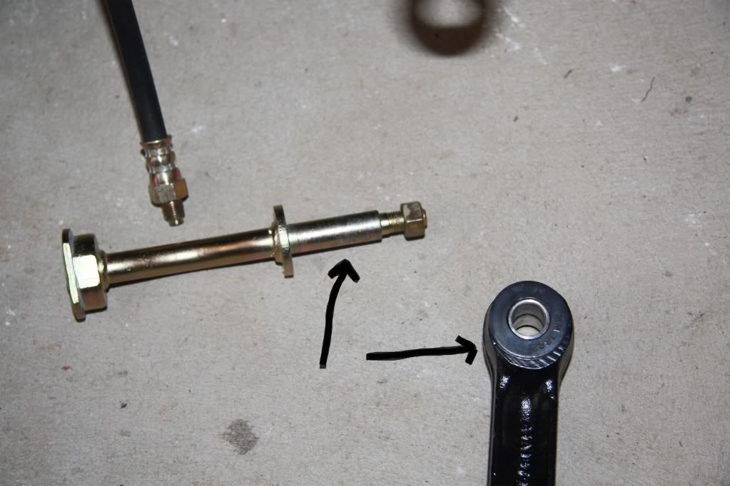

Do I apply grease to the two items of lower front suspension in the picture.

NO, not with the original live rubber bushes you have pictured.
YES if fitting polyurethane bushes (but I found they don't last). :wink:

Thanks drmini
