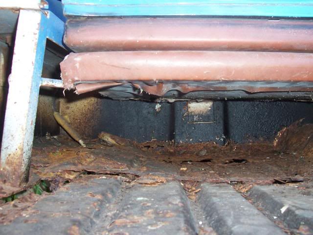

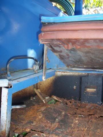

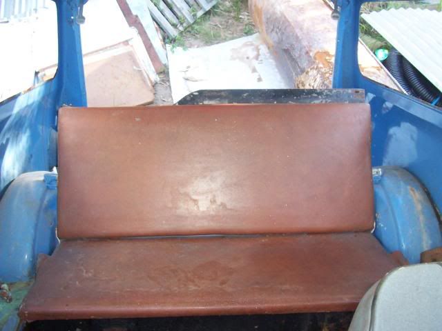

This is a seat out of a wreck I had. non engineered and very crude but a good base for an idea. If I ever put a seat in a van it will be done similar to this.
Is the floor that way so that the rear passenges also have to pedal?
