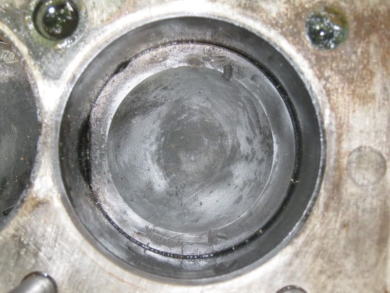

Did a -quick- look around, all I can see for NEW crankshaft prices are in the range of $2K???, What type of cranks aren't I finding?
Will need new pistons (http://i120.photobucket.com/albums/o170/hoobiedoo/sven/IMG_1431.jpg). conrods have a few scratches but look straight - mechanic checking them and i'll find out tomorrow with the prices for a rebuild.
How many cranks are you buying for that price? Send me a PM if your looking for a new crank.
