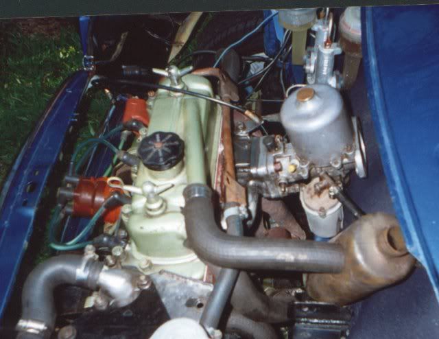

big big for the average road mini, but works well on my 1510cc
