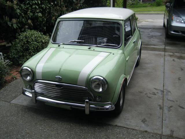

Wow Greg, that is all really helpful and I would love to have the photos! Maybe you could upload them to a public hosting site, i.e. photobucket.com or something like that?
I do have the original tamarisk green sticker from the firewall, but it is in bad shape and I would love to buy that and the lap belts from you. Any leads on original front belts also? I went to look at the car just now, and as it turns out, the holes for the seatbelt mounts are also there on the fenders (never saw them before), but not drilled out, i.e. inner metal has the holes, outer metal does not. In the bulkhead behind the rear seat there are just holes into the boot where the nuts would go in later cars. The mounts I bought are on this page, seventh item down:
http://www.minisport.com.au/category59_1.htm
Here again, photos of how they were actually done would be great, before we go welding something in that doesn't make sense.
I don't believe the car was police pack. The current carbs are 1.25. Are there other signs that would indicate police pack on it?

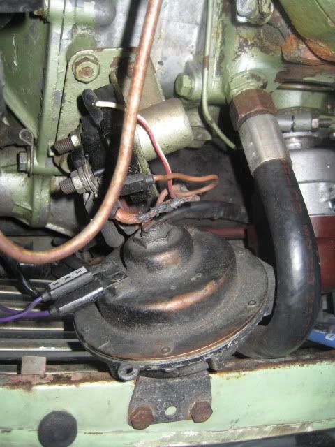

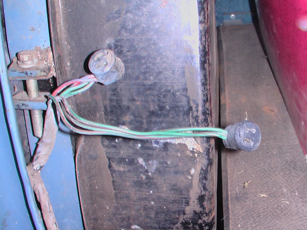

Here is a photo of my horn--you can see the melted wire just aft of it (is that the starter relay that the wire attaches to?):
In that same album is a cool sticker under the rear seat, driver's side, "prime and paint OK, BLMC". Wish I could find that one too! Do you have any leads on where to find the tamarisk green paint in an accurate match?
Again, many thanks.

Well I'll be damned! I had a look over the car this morning, and I think it is ex-Police after all. Here's the list from the other thread, and comments on my car with some pictures below. Would it be safe to assume that the 1.5 carbs could have been pilfered to another car long ago, and replaced with the 1.25s that are on there now?
Is having an ex-Police car a good thing or a bad thing? I think it's kind of cool, and definitely makes me want to put it back to mono tamarisk green to further embrace the history of the car. Not sure about putting all the bits back, but maybe? I assume they are pretty much unobtanium?
1. Handbrake warning light switch (or the hole where it was fixed).
--I don't see this, but there is an unidentified bolt head just forward of the brake on the driver's side, right up against the cross member.
2. Warning light itself (not present on your binnacle, which could've been swapped).
--Not present, but what color wire would be taped out of the way behind the speedo/binnacle if it's there?
3. Two-speed wipers (wires imbedded in wiring loom)
--Single-position wiper switch, three wires to the wiper motor, but a fourth wire with terminal is present and taped back out of the way.
4. Reversing lights (wires in wiring loom and twin-filament globe holders for turn indicators).
--Haven't looked at the wiring yet, but the indicators have twin-filament bulbs and come on when reverse is engaged.

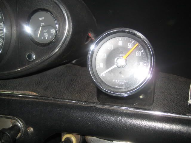

5. Holes under the top crossrail in front of the driver for Smiths tacho bracket.
--These are present, to the right of the driver's centerline. Smiths tacho is also present, but mounted in the shelf forward of the driver instead of the top rail.
6. Lowered front seats.
--Not sure how to tell this.
If used by NSW Police:

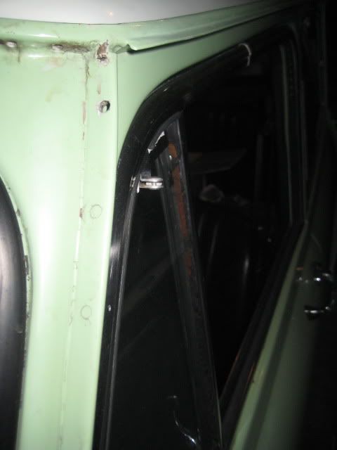

7. Holes in top of front seams for mesh sun shield.
--Three holes on each side, filled but visible, I've removed filler from one in the photo.
8. Hole in the middle of the roof for aerial.
--Present, can definitely feel it through the headlining and also the filler is cracking on the roof.
9. If country-based car, holes in subframe for sump guard and holes in valance for driving lights.
--Subframe has three holes about 3/16" in diameter, valance has holes just inboard of the bumper mounting points (two) at the edge of the seam where the bumper mounts, and also has two holes between the grille and the curve towards the bumper (two, filled). Both are approximately the same spacing as the lights in the picture of the wrecked police car.
10. Pair of holes to the far left of the parcel shelf for brass ID plate.
--Not sure about these. All I see is the factory speaker hole with four screw holes in a square around it. Do you have a picture?

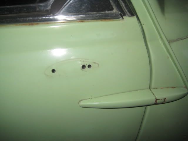

11. Telltale marks made by two grub screws in the leading edge of the door where Wibroc mirror was fitted.
--Picture attached of the holes in the doors. At least two of them were for bullet racing mirrors, but other holes on the car have been filled and at some point I'll have a look behind the door skin to see if these are present. Were they two holes vertically, or horizontally?

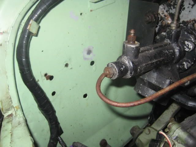

12. Holes in front of power brake booster for siren.
--I believe I have these, photo attached. Would this also account for the car horn being moved to the apron panel, instead of being mounted on the inner right guard?
So, what say you all? Ex-NSW police car? Does "country car" mean it was used out of the city?
Yikes, I'm pretty stoked right now. Very fun to learn more about the history of the car.
Ben McCafferty
Ben McCafferty
1970 ex-police mk2 Cooper S
