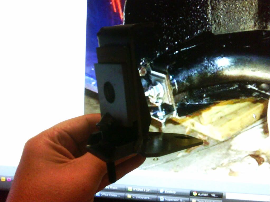

Does anyone have a pic of their adjustable camber brackets on the rear of the car (in situ). Just trying to get my head around how they locate! :?

Looks like this is what I'm up against.

Looking at that pic I would have thought 6pm.

That's not the way mine fit.. mine are as the pic above. The strakes on the plate with the threaded rod mate with those on the bracket itself, which are vertical. This adjusts the camber.

From what I can tell and what I've read adjustment is as follows....
Camber - sliding the adjustable bit up and down in the grooves
Toe in/out - Moving the adjustable bit forward in the serrations = toe in. Each serration adjusts track by 0.040".
This is correct, at least for the MiniSpares items I have on my car ;)

Shocking shot from my Blackberry, but looks like this is the way they should go. Yep, they are Minispares too.

i recently fitted the minispares set. had to file 2 of the holes out on each bracket as they didnt quite line up. the pic you posted looks all good. just be careful when removing the old bracket as the bolts can snap quite easily, i found out the hard way :lol: the water just gets in there and just sits, especially in the bottom ones.
Is there a rough guide as to what this equates to in degrees. I know I'm going to have to 'take it to the man' but should I be aiming at moving "x" serrations forward to achieve "y" degreess toe in.
Obviously the major variable there is 43 years of the suspension components being bashed about!
Yes, that's correct. As for the initial settings and adjustment, you're just going to have to bolt them up, measure the toe yourself (more or less) and then (optionally) get it done professionally. Mine was so far out of square on one side it took all the bracket's range to get toe-in.
