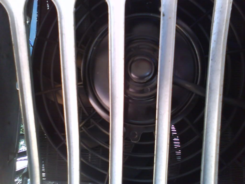

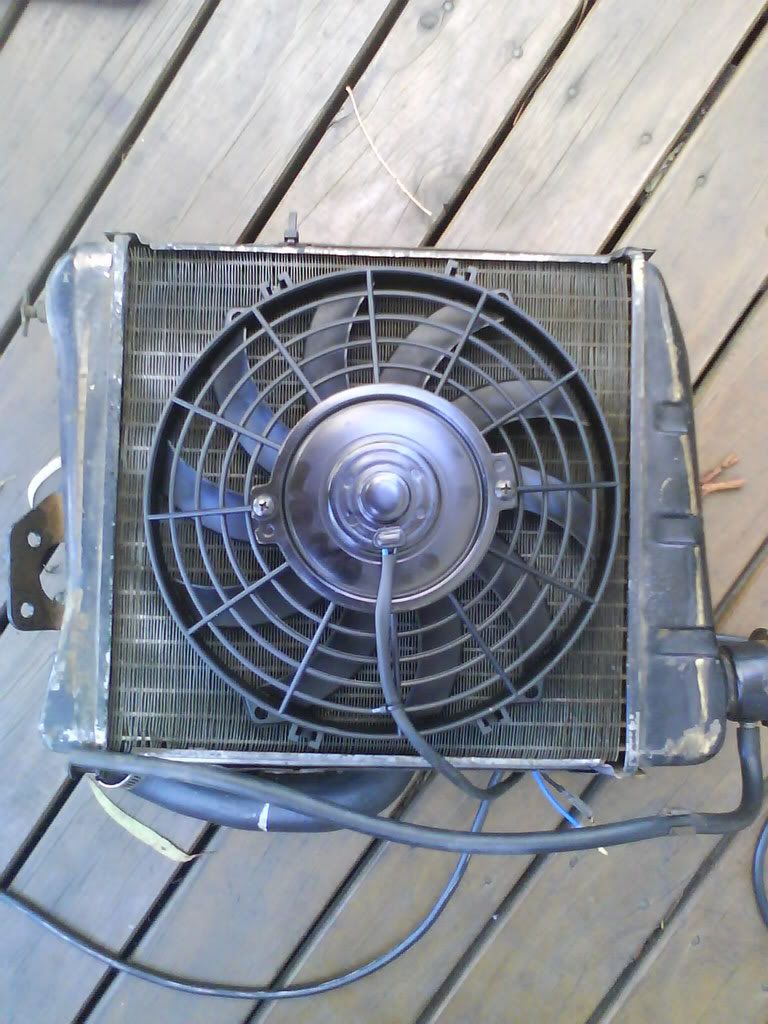

hey guys can some one post up some pics of were they fitted there thermo fan cause mine wont fit and i cant work it out thanks :)

PostPosted: Thu Feb 03, 2011 8:27 am
Milatsmadmini
Posts: 6287
mattsmadmini wrote:
fitted my thermo (at present just on always through 12v ign. all fused up nicely...
just a 25 buck ebay buy, great flow for a 9"
fits like a glove!
There ya go

PostPosted: Thu Feb 03, 2011 10:29 am
Cooper_Matrikon wrote:
How do you mount it in the inner guard?
You don't. It comes with a fitting kit that attaches it to the radiator through the core.

One of these puppies?
http://cgi.ebay.com.au/Chrome-Body-9-INCH-THERMO-FAN-kit-electric-fan-/220725287949?pt=AU_Car_Parts_Accessories&hash=item3364409c0d#ht_3451wt_1139
PostPosted: Thu Feb 03, 2011 10:40 am
That looks like a good buy for under $40
Those are the mounts I use too.

PostPosted: Thu Feb 03, 2011 1:01 pm
Milatsmadmini
Posts: 6287
Fat Boy Dave wrote:
How did you fasten that one in Matt?
The same way AWD mentioned...it did make it a bit more fidely for a while, but have now changed radiator and shroud, so no probs :)
