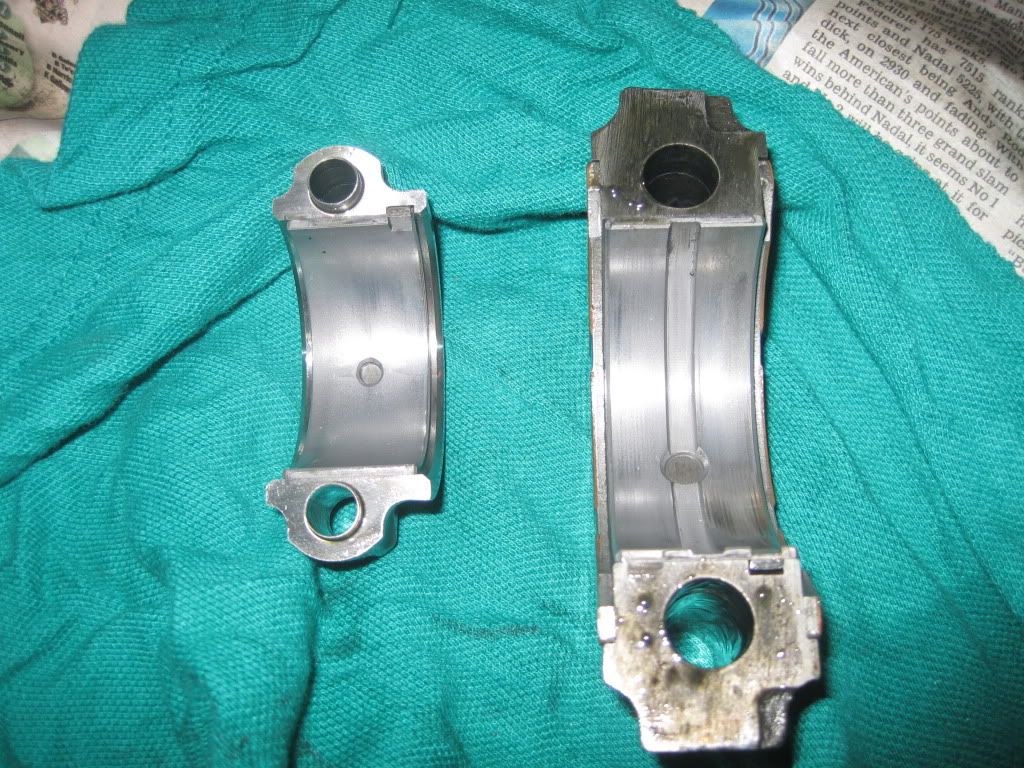

Here's some photo's of my crankshaft and bearings after 14 meetings. marginal signs of wear on the bearings. But the crank looks and feels and measures like it is brand new. Pity I couldn't say the same about the Camshaft.

The bearings are good enough to go back in, give it a hone new rings service the head and away you go.

GR, What oil clearence do you run on this Crank ?

This motor was a bit tight i gave them a size to grind the crank to but when they nitrided it it grew a bit in size it had .001 tho on the mains and pins so i just gave it a good run in on the dyno.
