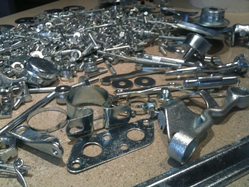

Zincing bolts. Worth doing???
PostPosted: Mon Feb 14, 2011 10:04 pm
Totally!
You can fill a 20 litre bucket with whatever and drop it off at a zinc platers. It will cost maybe 80 dollars for 20 litres of whatever you can squeeze in there. They will ask you if you are after yellow, black or silver plating and they will take maybe a week to two weeks to finish the job.
The benefits you get from having the bolts degreased is value on its own, then you start start putting things back together with all the pretty nuts, bolts and plates. Then you only regret what you didn't throw in the bucket.
PostPosted: Mon Feb 14, 2011 10:07 pm
Posts: 5518
Excellent. Off to get it done tomorrow.
How do you go about not getting the stuff all mixed up in the process? Or will it just be fun sorting through it all once you get them back??
PostPosted: Tue Feb 15, 2011 6:04 am
Use a digital camera to take pictures of groups of things you would like to keep together. With the barrel plating process it will all be jumbled up and there's nothing you can really do about that, but you can find them all easy enough if you have a decent pictures before they go. I sort them out once they're back into their associated groups.
Make sure the place you take it to can perform barrel plating. Its cheaper, but the trade off is that a couple of bolts won't plate as well as the rest, and you can lose the really tiny stuff, although they are pretty careful all the same.
Consider keeping the really tiny stuff at home, its not worth risking them being lost. I am happy to send 1/8th self tapper screws, but am not keen on sending out the very smallest of unique formed shape washers for instance.
